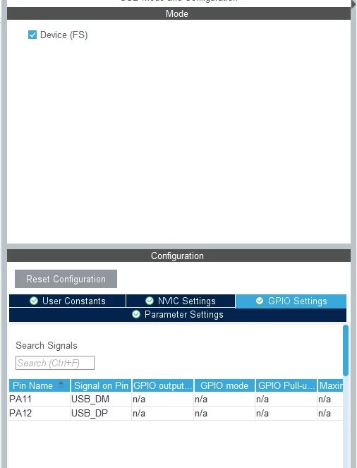

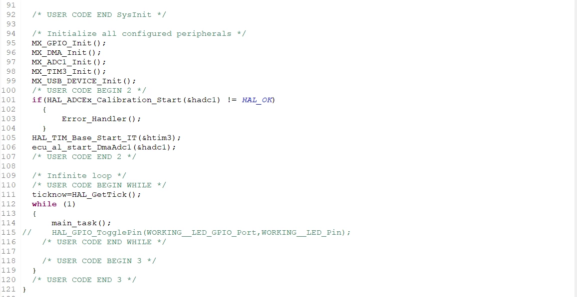

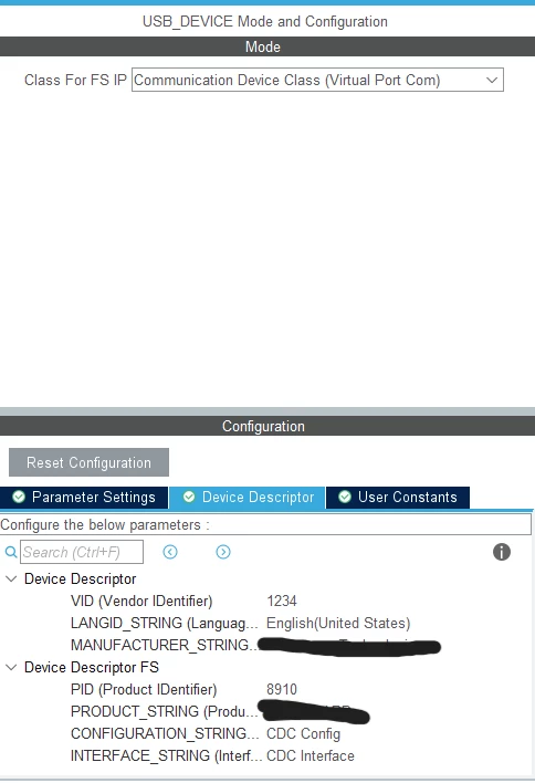

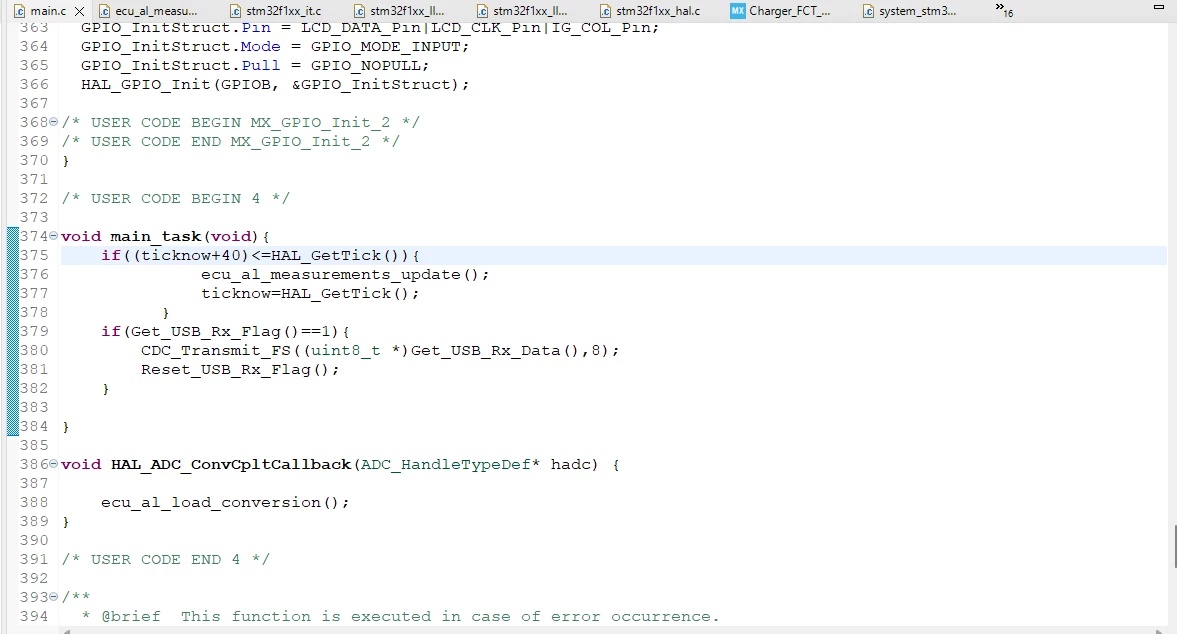

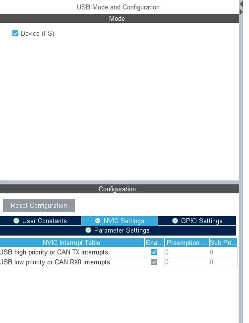

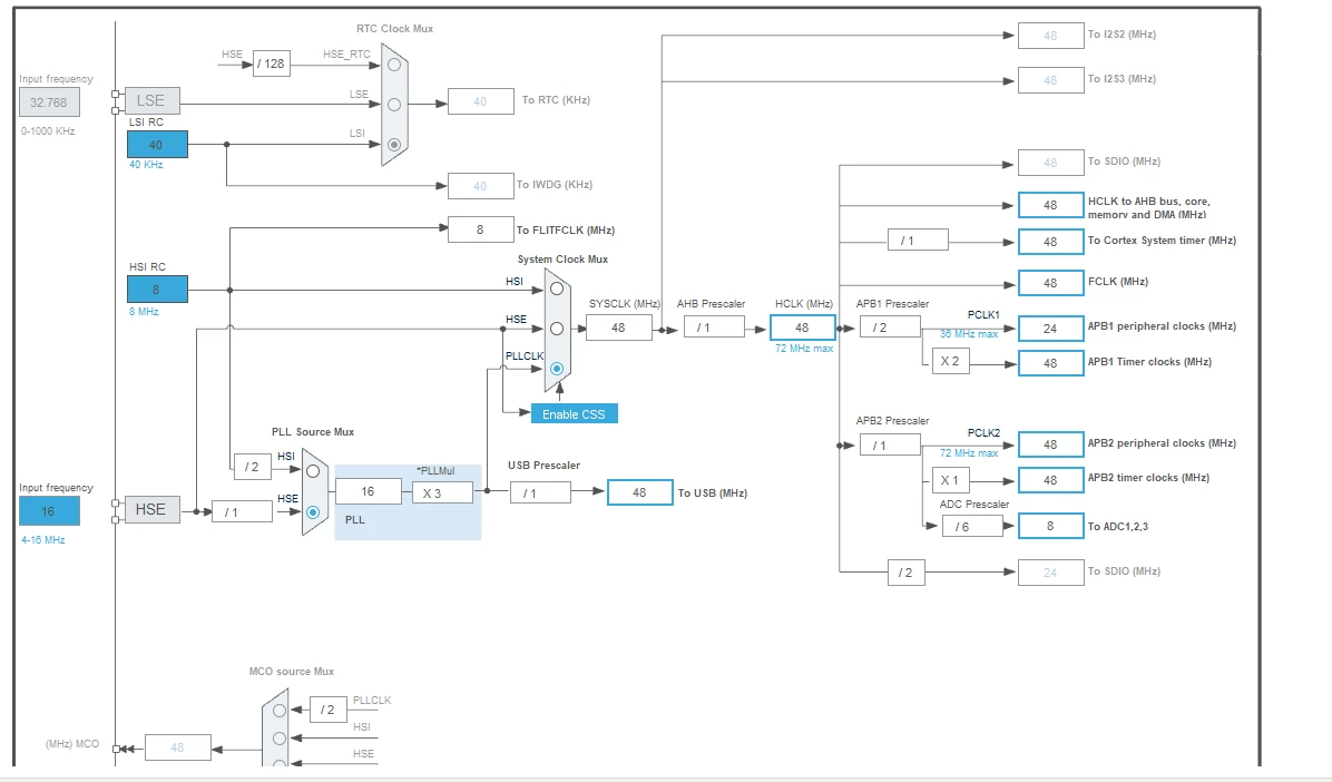

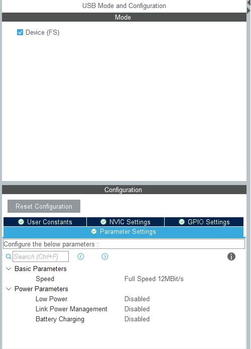

Hello Everyone,
Right now i am facing the issue on detection USB.I am attaching snap shots of the my USB configuration.
USB port not shown after powering up the board. i am doing some basic thing like on receiving via USB in RX interrupt function of USB i set one flag that will used in main function for further process.
Help Me if anyone knows the issue, i stuck here since 2 days.
STMCubeIDE Version:- 1.13.2
MCU:- STM32F103RET6
Debugger:- Jlink(4000Khz)
USB DP:- PA12
USB DM :-PA11
Internal Power Supply used which is given to MCU and other board peripheral.
Screenshot 2023-11-07 120759.pngScreenshot 2023-11-07 120821.pngScreenshot 2023-11-07 120821.pngScreenshot 2023-11-07 114158.png

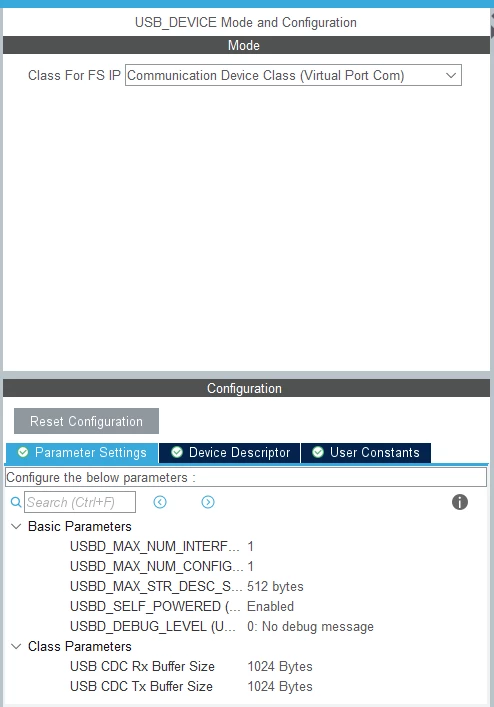

If there is a need to increase stack and heap size, make them at least 1024 bytes or more. Pullup resistor is required only with F1 series. The built-in USB bootloader is not present in F103, so some of the information you provide is false or at least incomplete.

Check the USB cable and the operation/frequency of quartz oscillator. Some versions of USB stack may require increased stack or heap size - set both to 2048 just in case. And, as I wrote many times in the past, calling USB Transmit from the main loop will sooner or later hang the USB stack, but it's another story - deal with it after the device is detected.

So maybe you should use The Force... I mean the debugger. Comment out your ecu-related calls, leaving only USB initialization, then check what happens.
My wild guess: continuous ADC conversion causes continuous ADC interrupts consuming all the CPU time with no time left for any other processing.

Increase the stack and heap size in CubeMX project settings. The RX and TX buffer size settings in CubeMX are pure nonsense - only 64 bytes of RX buffer are ever used and the TX buffer is not used at all.

is there a 1k5 pullup on usb DP ?  ( otherwise no enumeration starting...)
November 9, 2023
as per schematic no pull up on DP pin, It is mandatory to detect USB?
AScha.3
November 9, 2023
yes.
ie.   R6 1k5
