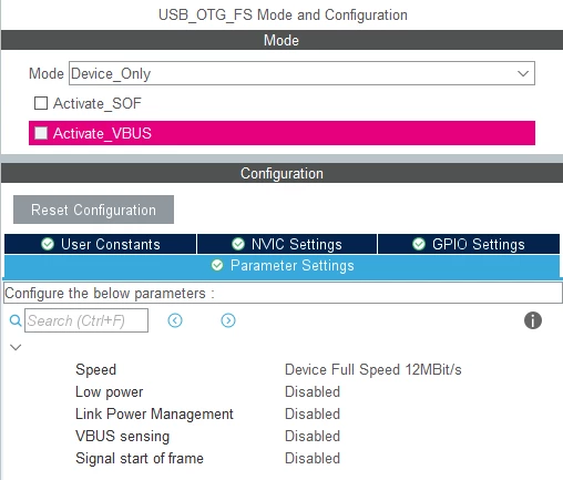

I'm currently encountering an issue with USB CDC on the STM32F466: the device is not being recognized as a USB CDC device.

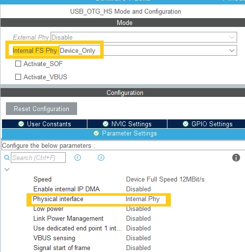

I'm using the USB_OTG_FS peripheral, with the USB_DEVICE middleware configured as CDC. However, in the Parameter Settings for USB_OTG_FS, I don't see an option for Internal PHY.
I then tried using USB_OTG_HS with Internal FS PHY instead, and in that configuration, the Internal PHY option is available in the parameter settings.
So I'd like to confirm the following:
Is the Internal PHY option only available when using Internal FS PHY (i.e., only through USB_OTG_HS configured for FS mode), and not available for USB_OTG_FS directly?
If I need to use CDC with USB_OTG_FS, do I need to add external pull-up resistors (since there's no internal PHY option to handle this automatically)?

hello ​@Jerrylin00
For the STM32F446, which is most likely the product under discussion, there is no STM32F466. The STM32F466 reference appears to be a typographical error.
For USB_OTG_FS, the device automatically uses the internal full-speed (FS) PHY.
For USB_OTG_HS, the device can use the internal USB_FS_PHY to enable the USB_OTG_HS instance in full-speed mode, or it can use an external PHY for high-speed mode.
As far as current knowledge indicates, the STM32F4 family does not require external pull-up resistors. Only the STM32F1 and STM32F3 families require an external pull-up resistor.
