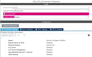

I am trying to add a USB device CDC for debugging. My objective is to print debug data on the virtual port com. I am sucessufull at sending data directly after the USB CDC init but when I use another module, the USB isn't working anymore and the TX function if returning a Busy error

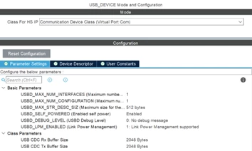

I configured the USB with the following parameters: (Clock to USB = 48MHz)
The USB is initialized fine and I can open the Port Com on my computer.
If I put data to the usb directly after the USB init it is working, but once I use another peripheral (UART, SPI…) the USB no longer outputs any data and the function CDC_Transmit_HS returns a busy error
