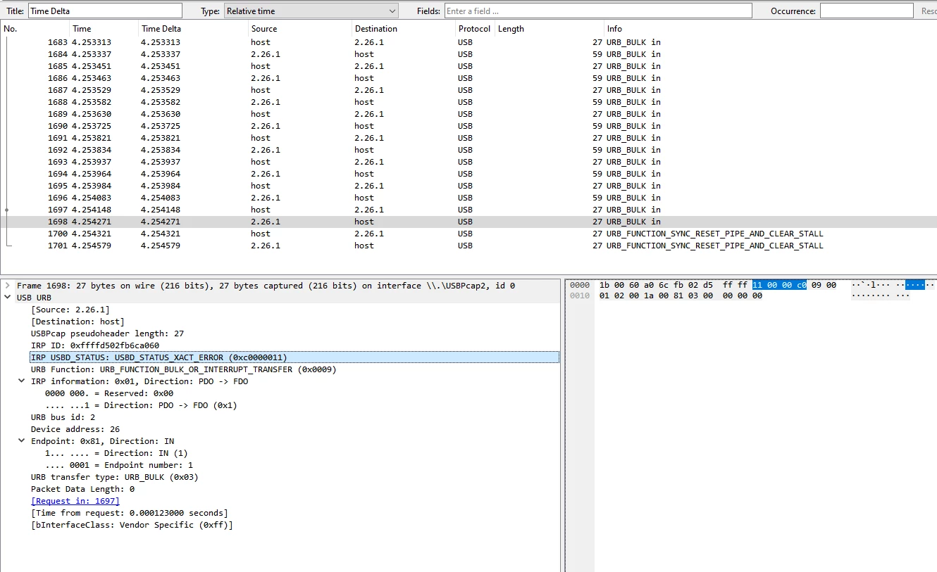

I'm creating a new USB device with a custom USB class on an STM32F779NIH.  We have previously developed a fully operational device doing the same thing with USB full speed, now we're trying to do the same with USB highspeed using an external ULPI. I'm reasonably certain the issue is firmware not hardware.
The overall scheme is using bulk transfers to send data out at a periodic rate, say 1ms for example, so 8 microframes will elapse before data is sent back to a read request. The PC read function will blocks until it receives that data which creates a timing loop that turns out is quite resilient compared to Windows timers. Anyway, back to this device, when I run my user application, it will generate a read request for which the device will return a response after 1ms with a set of data which is correctly decoded.  This is repeated 8 times, but on the 8th packet, my device returns no data and a status of 0xC0000011 (which is a USBD_STATUS_XACT_ERROR) according to WireShark:
According to page 34 of this PDF: https://www.intel.com/content/dam/www/public/us/en/documents/technical-specifications/ehci-specification-for-usb.pdf it may mean:
Set to a one by the Host Controller during status update in the case where the host did not receive a valid
response from the device (Timeout, CRC, Bad PID, etc.). This bit may only be set for isochronous IN transactions.
However, 1) this definition is for isochronous, 2, the bit position doesn't align with the data in the image above, and 3) as far as I can tell, this is being set somewhere in the device firmware rather than from the host. This is the first time I'm using a ULPI, so I'm uncertain if perhaps it is generating this directly. I'm am, however, fairly certain this isn't a timeout issue (at least from the device side) as the PC blocks until it receives the data.  I can run the device as fast as one packet per 125us, or slow it down to slow it down to 2ms and it always throws the error on the 8th packet.

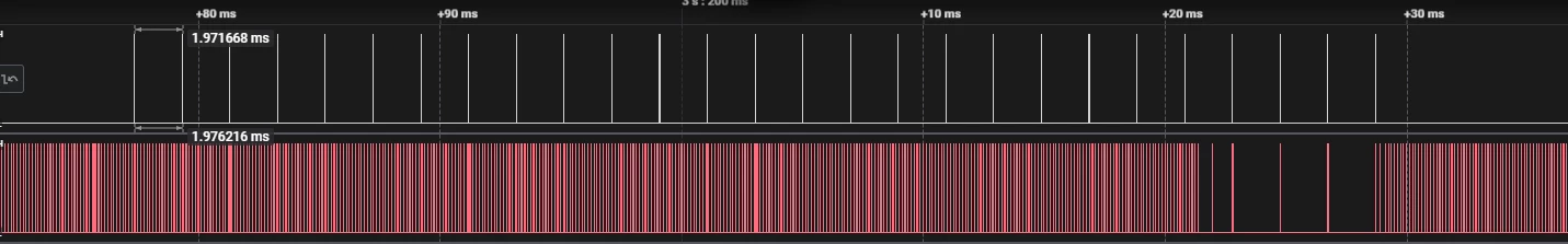

In the mean time, I did make one other interesting discovery.  I stripped down the PC side to just basic libUSB reads so even though there is a bus reset, it will try to keep reading.  On the following plot, the upper trace is the device 2ms timer interrupt for sending data. The lower trace is the global USB interrupt.  This is immediately following a bus reset:
Generally, these interrupts come in on the microframe (125us) as expected, but whenever data is sent out, we'll also have an interrupt for the next read request as well (not sure what the third interrupt is for):
Shortly before it starts to experience problems, we stop seeing an interrupt response to transferring the data:
Then we stop getting the 125us microframe interrupts. At this point, the data is still being received by the PC (I can correlate what is sent with Wire Shark) and I *think* I'm only getting the read requests, but something else has stopped (still investigating exactly what that is).  The bus is reset again (the 125us interrupts come back on the right) and the whole process repeats until the next time an error occurs:
When I try to send data every microframe, it stalls for every 8 packets received, but as I slow it down, the number of packets between stalls becomes more variable.

So in hindsight, I think (and someone please correct me if I'm wrong) that the error I saw on WireShark was effectively telling the PC that the FIFO was full. Normally if the PC was first requesting the data then it would be a failure on the PC side to read the data after it had requested it, but since this was more of a "push" approach, the PC simply wasn't keeping up and particularly when running as a normal-priority process a single delay from the OS running another process caused the FIFO to overfill quickly.
