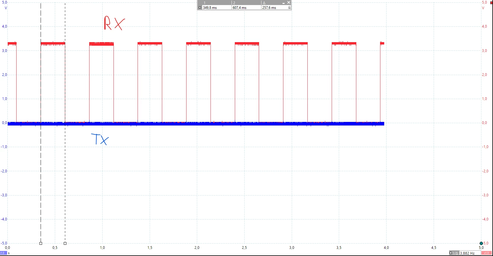

Hello everyone,
I successfully used USART1 and USART3 in my application. However, when trying to use USART4, Rx is working but not Tx. The idle signal stays at 0V all the time.

No short-circuit on Rx or Tx. I am measuring signal at MCU output and there is nothing after.
I tested everything I could think of. You will maybe have other ideas. Tell me if you need more details (registers values, function output, signal measurement). Thank you in advance.

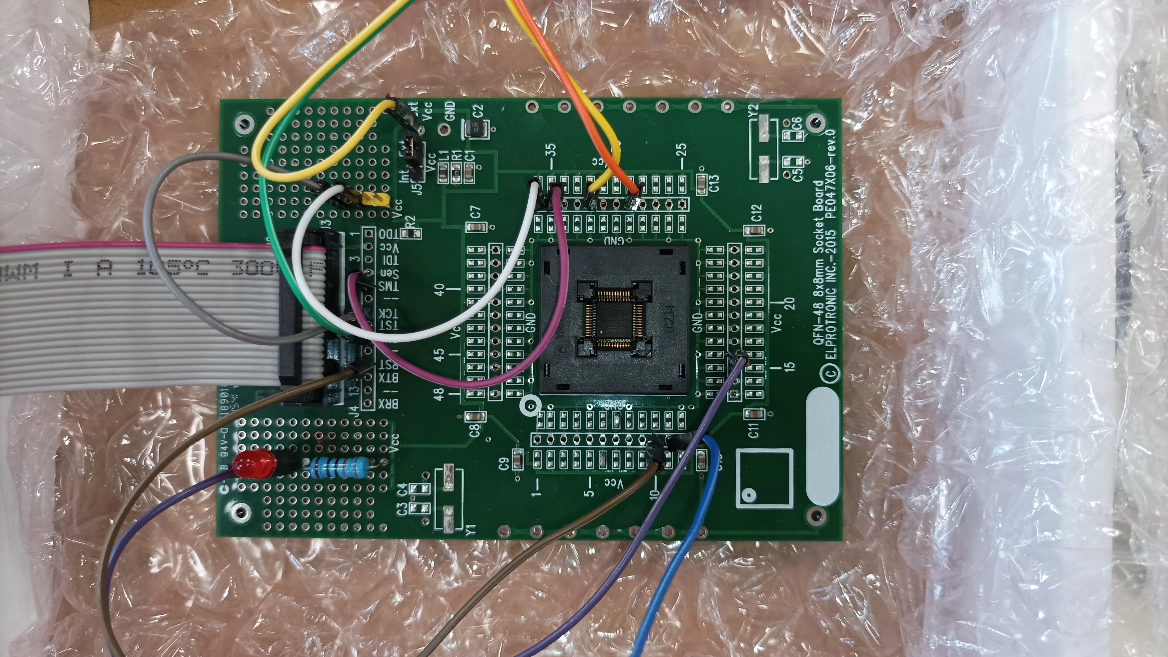

PSicl.2
PSicl.2Author
June 17, 2024

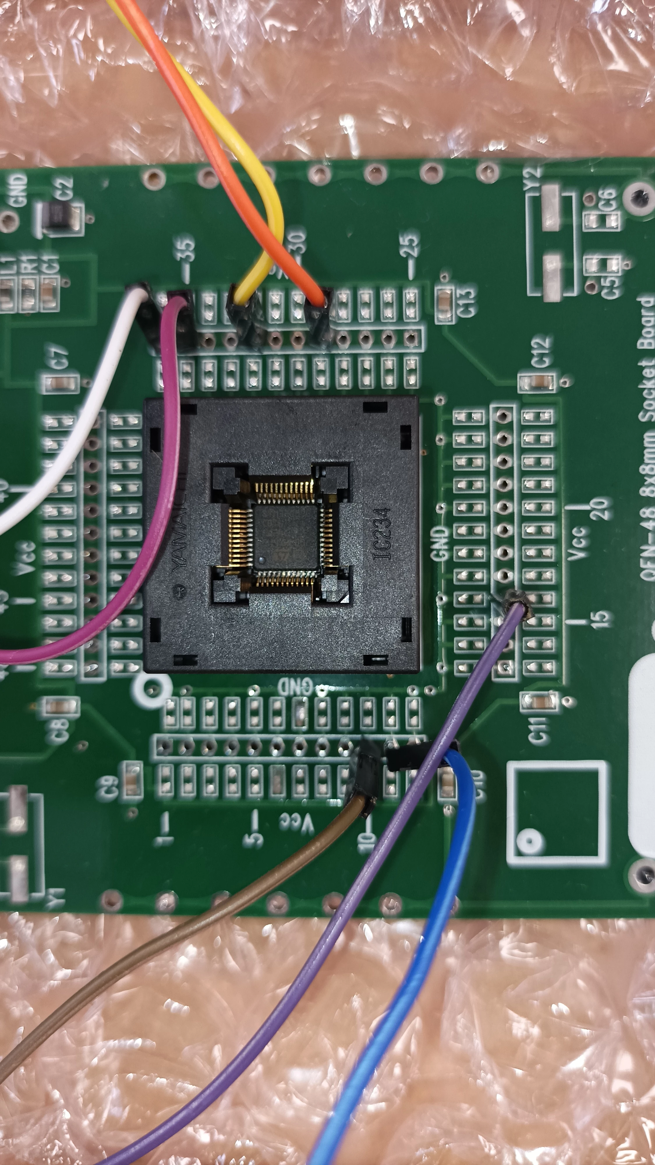

To try with a minimal hardware configuration, I used the following socket : PE047X06.
For the program, I used a minimal one straight out from CubeMX with only :
 while (1)
 /* USER CODE END WHILE */
 /* USER CODE BEGIN 3 */
 HAL_GPIO_WritePin(GPIOA, GPIO_TX_Pin|GPIO_RX_Pin, GPIO_PIN_RESET);
 HAL_Delay(256);
 HAL_GPIO_WritePin(GPIOA, GPIO_TX_Pin|GPIO_RX_Pin, GPIO_PIN_SET);
 HAL_Delay(256);
Still the same result. Nothing on PA0 (USART4_TX).
Could it be an issue from ST hardware or firmware ? What could I do to give you more information ?
Thank you.

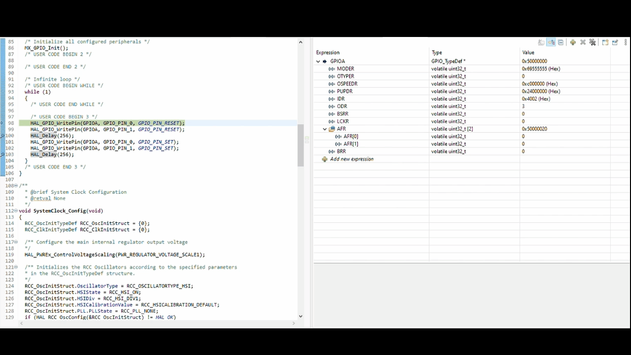

waclawek.jan
June 17, 2024
In debugger, stop the program and check/post content of GPIOA registers.
You can also try toggling directly in debugger.
PS. Connect VBAT to VDD and make sure it powers completely down to 0V before starting again, because of the "backup domain brownout" erratum. You can try to perform the backup domain reset in software, too.
PSicl.2
PSicl.2Author
June 17, 2024
Here is a video of the GPIOA registers during SET or RESET :
As you can see, ODR is set to 3 in SET state and to 0 in RESET state which seems normal.
I tried with a NUCLEO-G070RB devkit and I can reproduce the bug. I can't output signal from PA0.
I also tried with all pin from Port A and they all worked except PA13 (SWDIO), PA14 (SWCLK) and of course PA0.
There might be a conflict with something else.

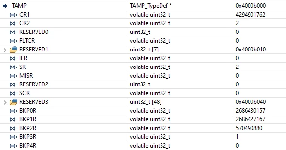

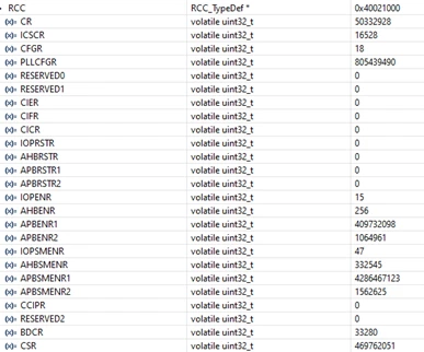

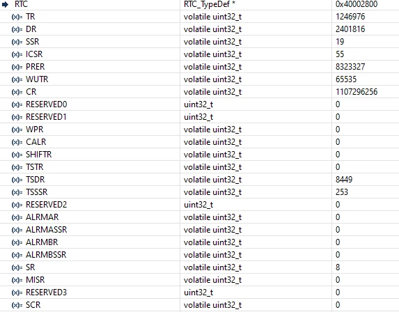

Here are RTC, RCC and TAMP registers.
RTC
RCC
TAMP
I tried to reset backup domain on my Nucleo-G070RB with minimalist code by setting RCC->BDCR->BDRST to 1. It worked, I was able to control PA0. However, when doing the same thing at the beggining of my application, it doesn't work.
By looking at the registers, do you know why I can't control PA0. Does it have something to do with RTC_TAMP_IN2 ?
PSicl.2
PSicl.2Author
June 18, 2024
In TAMP register, CR1 is showing TAMP2E enable.

waclawek.jan
June 18, 2024
> Do you think it could be the answer ?
Yes; if you set PA0 to TAMPER it overrides the GPIO settings.
I don't know how do you set TAMPER to use PC13; I don't use TAMPER and I don't use Cube.
PSicl.2
PSicl.2AuthorBest answer
June 18, 2024
Thank you so much waclawek.jan for helping me.
So to recap, PA0 was not usable because TAMP_IN2 was enable and was overriding GPIO settings.
The solution is either:
  • Disable TAMPER
  • Move TAMPER from IN2 to IN1 on PC13
In addition, to disable TAMPER on IN2 (PA0), you can use HAL_RTCEx_DeactivateTamper function. Or if you don't use HAL, you can change TAMP->CR1 register.
