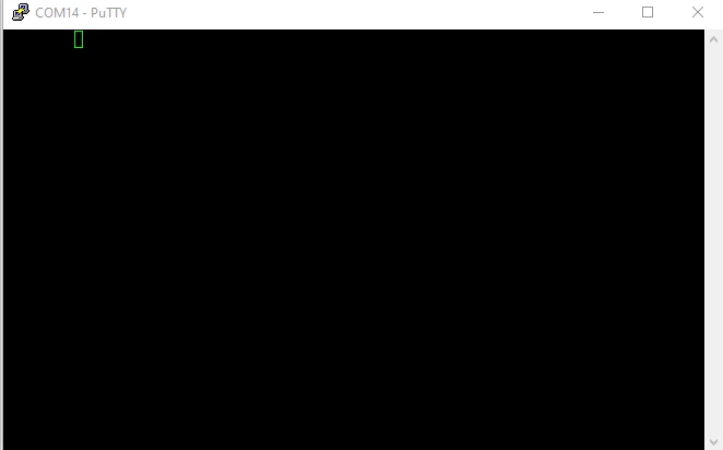

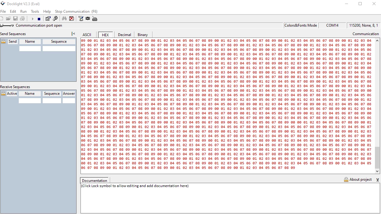

USART2 output not showing up on putty, but shows up in DockLight? (NucleoF411RE)
i am transmitting some values from STM32 through serial, and even though i have set the Baud Rate and Parity bits in both DockLight and putty, it shows only on DockLight . I am using the HAL library. Also, i tried receiving data from STM32, and while it works, it still shows nothing. What i am looking for basically is Arduino's "Serial.print and Serial.println".

Better use printable ASCII values. The test values you’re using are non-printable.

Rozakos
RozakosAuthor
Jul 24, 2020 11:54 AM UTC
Dang, thank you very much!
