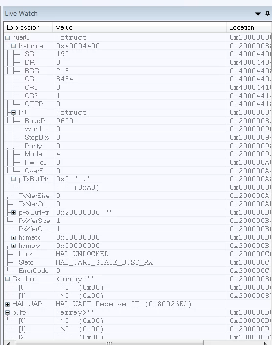

edwin marcellin
May 18, 2018
Posted on May 18, 2018 at 12:30
Thank you for your help.
Without launching my code, when i open an hyperterminal (Tera term) i receive the data with the good format. so i think hardware part and configuration of uart is ok
When i launch the code with a
breakpoint in here: HAL_UART_RxCpltCallback, i have the message ''One or more breakpoints could not be set and have been disabled''. So it diactivate my break point and when i launch the code, i never go into this function
HAL_UART_RxCpltCallback.
When i do the HAL_Init(), i have HAL_OK
My configuration is:
GPIO_InitStruct.Pin = GPIO_PIN_2|GPIO_PIN_3;
GPIO_InitStruct.Pull = GPIO_PULLUP;
GPIO_InitStruct.Speed = GPIO_SPEED_FREQ_VERY_HIGH;
GPIO_InitStruct.Alternate = GPIO_AF7_USART2;
HAL_GPIO_Init(GPIOA, &GPIO_InitStruct);
In my hyperterminal, i still see the data.
But if i check my variables buffer, RX_data... are fixed to 0. Is it normal that i don't have StopBits?
I'm a bit lost...

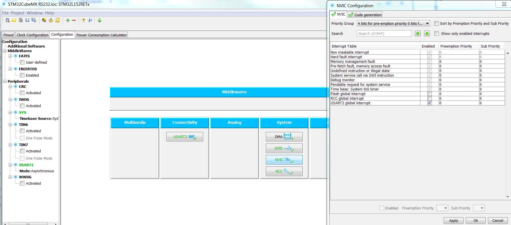

Pevy.Andy
May 18, 2018
Posted on May 18, 2018 at 12:38
Have you enabled the NVIC for the UART in the Cube tool ?.
edwin marcellin
May 18, 2018
Posted on May 18, 2018 at 13:25
I think so.

AvaTar
Senior III
May 28, 2018
Posted on May 28, 2018 at 09:36
Using a debugger with 'live watch' and viewing peripheral register data is a 'deadly' combination.
Several registers have flag bits that get reset upon read - like interrupt flags, for instance.
