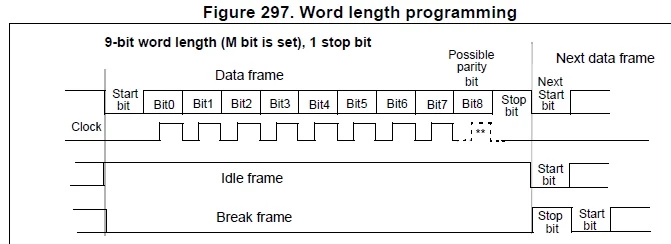

hi,I read the manual ,it says :''An Idle character is interpreted as an entire frame of “1�?s followed by the start bit of the next
frame which contains data (The number of “1�? ‘s will include the number of stop bits).''  ,So it needs a start bit ,i think this method cannot cause a interrut

I read the manual ,it says :''An Idle character is interpreted as an entire frame of ?1?s followed by the start bit of the next frame which contains data (The number of ?1? ?s will include the number of stop bits).'' , So it needs a start bit, i think this method cannot cause a interrupt
The diagram however pretty much defines that the idle frame is absent a start bit, it's basically an entire symbol time with the signal high.
While I see what you're saying, I'm not sure that makes sense. The arrival of a start bit prior to it clocking out would kill the idle detection, but the absence of a start bit for an entire symbol time wouldn't really need exact closure. I'd suggest you test whether the *next* start bit is actually required for it to trigger.

The idle detect is an event that marks the gap between the end of a message and the start of the next message.  It's an edge event, there has to be two messages arriving to detect the idle gap as the ending frame for the first, starting frame for the second.  So your requirement is a gap of more than one character time plus a guarantee a second message will arrive, or something like a sync character used as a filler between messages.
Using idle isn't a very good way to end RX DMA unless there is a constant stream of incoming messages so you are guaranteed a new message to complete the frame of the old message.  That's why ST recommends connecting the RX data input to a timer reset instead.  With a timer reset there's no dependency on the next message arriving in order to terminate the current message.
One of the best examples of this issue is the Modbus RTU (binary) protocol, where there has to be a minimum time between messages in order to detect an end of message framing mark.  Using idle won't guarantee the minimum time, and it stalls the completed message until a new one arrives (assuming it does, although the line may be turned around while the host is waiting for a reply, so no second message ever arrives).
