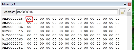

Emanuele Zampieri
August 7, 2020
In debug I only observe the contents of the circular buffer used by the DMA (_rxDataCallback).
In the circular buffer only the first byte of the sequence (C0 10 00 05 43 C0) I send is stored.
I tried to view the memory contents by activating the "live update" or inserting a breakpoint, in the buffer I always see only the first byte.

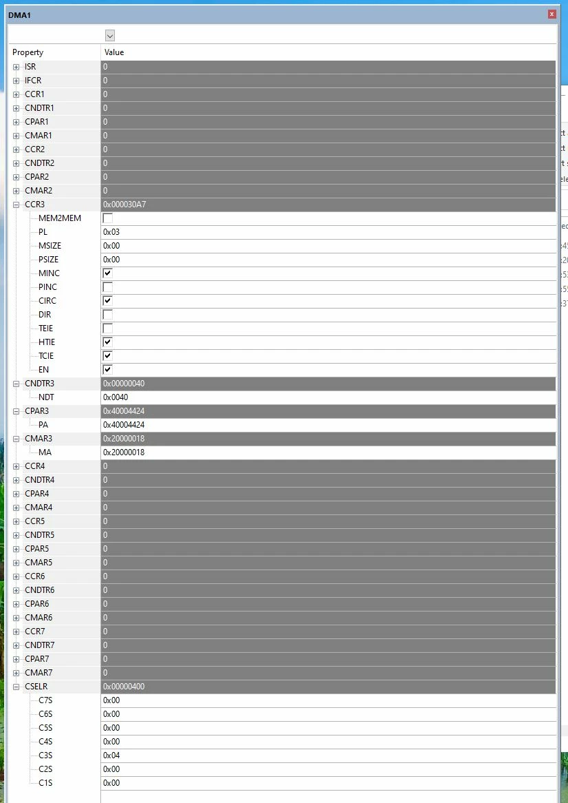

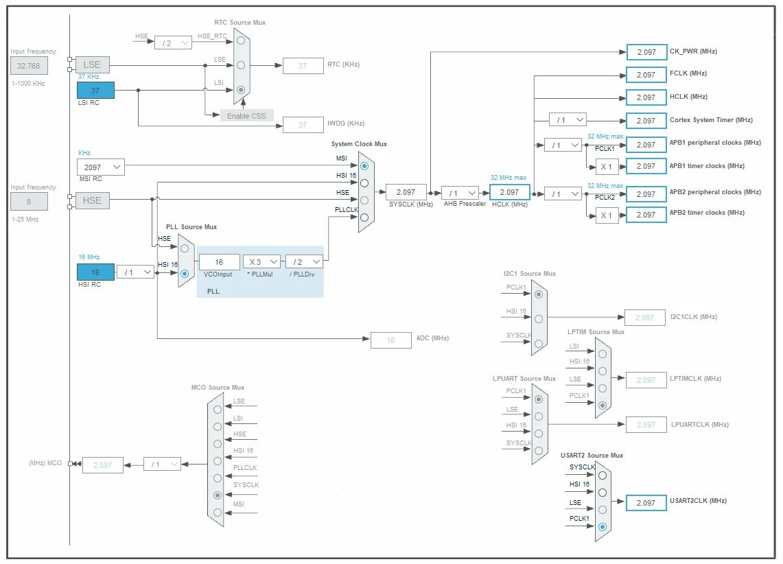

Sorry, maybe i didn't attach pictures correctly before.
The contents of the DMA registers remain the same after sending the packet.
I was already checking the ORE flag and in debugging I see that after sending the packet this flag is raised.
The USART2 baudrate is set to 115200 and the clock is set as in the image:
waclawek.jan
August 7, 2020
Then that is the problem.
Didn't data arrive before DMA is set?
Isn't there something interfering with DMA?
Write a minimal program with only the UART and DMA and nothing else. Still the same problem?
