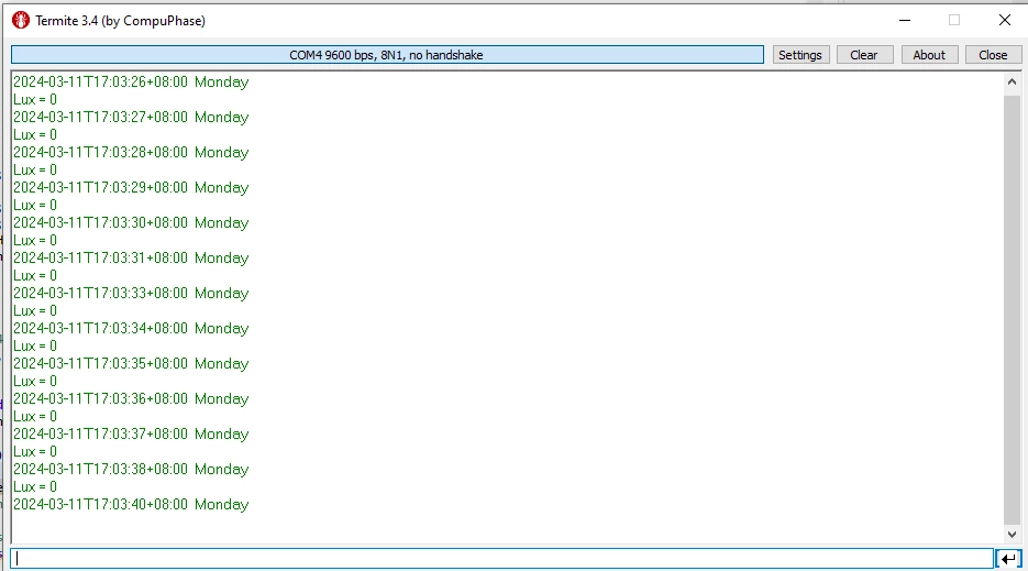

I was trying to send the data to termite terminal. The data variables are coming from DS1307 (RTC Module) and BH1750 (Lux) sensor. However, The data coming from lux sensor is zero in termite. Rtc module variable is okey. Lux sensor variable is declared as lux. When ı debuged it, ı can see lux value properly but the USART transmit 0. By the way, both of sensor is connected to I2C1 bus. I have Stm32f4 discovery kit. How can ı solve that ?

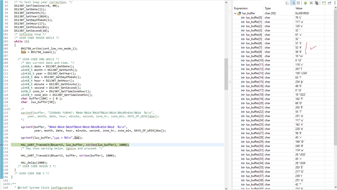

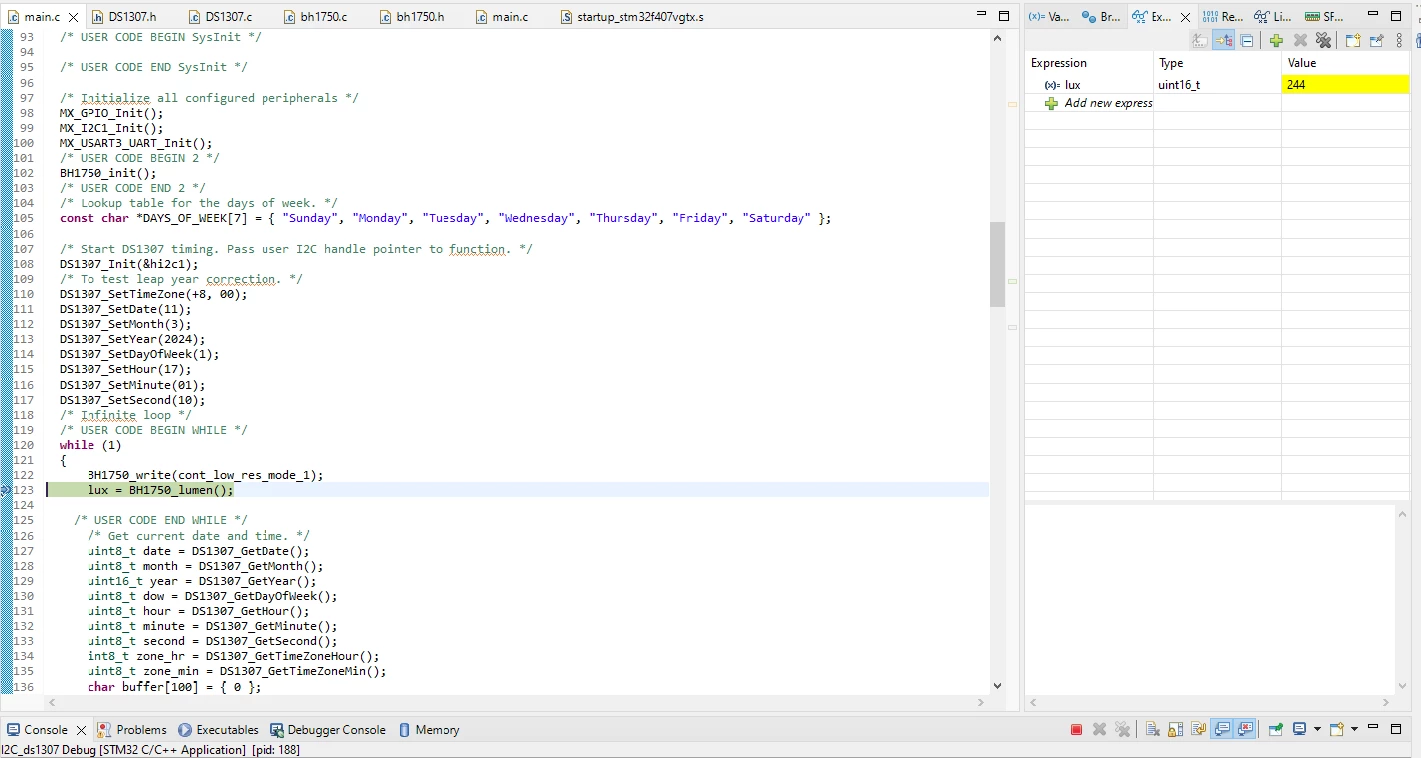

Set a breakpoint at HAL_UART_Transmit and look at the data within lux_buffer as well as the value of lux. Probably it reflects lux = 0.
In order to debug, change your code to lux = 42 (or whatever value).
March 18, 2024
I made debug and noticed that lux_buffer gives the true value as ı upload the image. However the terminal still shows that lux is zero ı changed lux to 50 though.
