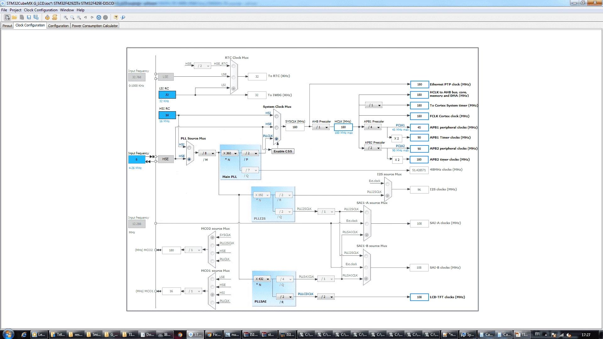

Hello
everyone
, I hope
you are well
I would like to
know how I can
write the value
9600 baud or 2400 baud directly
in the registry
I found
USART1-
BRR
but when I put the frequency / 9600, it does not work :
/, my frequencey it's 180Mhz. Thanks you :)0690X00000605bpQAA.png

    You'd have to divide into the APB clock for the USART, in this case APB2 at 90 MHz, and the value would need to fit in 16-bit
    For the 16x over-sampling case
    9600 BRR =9375
    2400 BRR=37500
