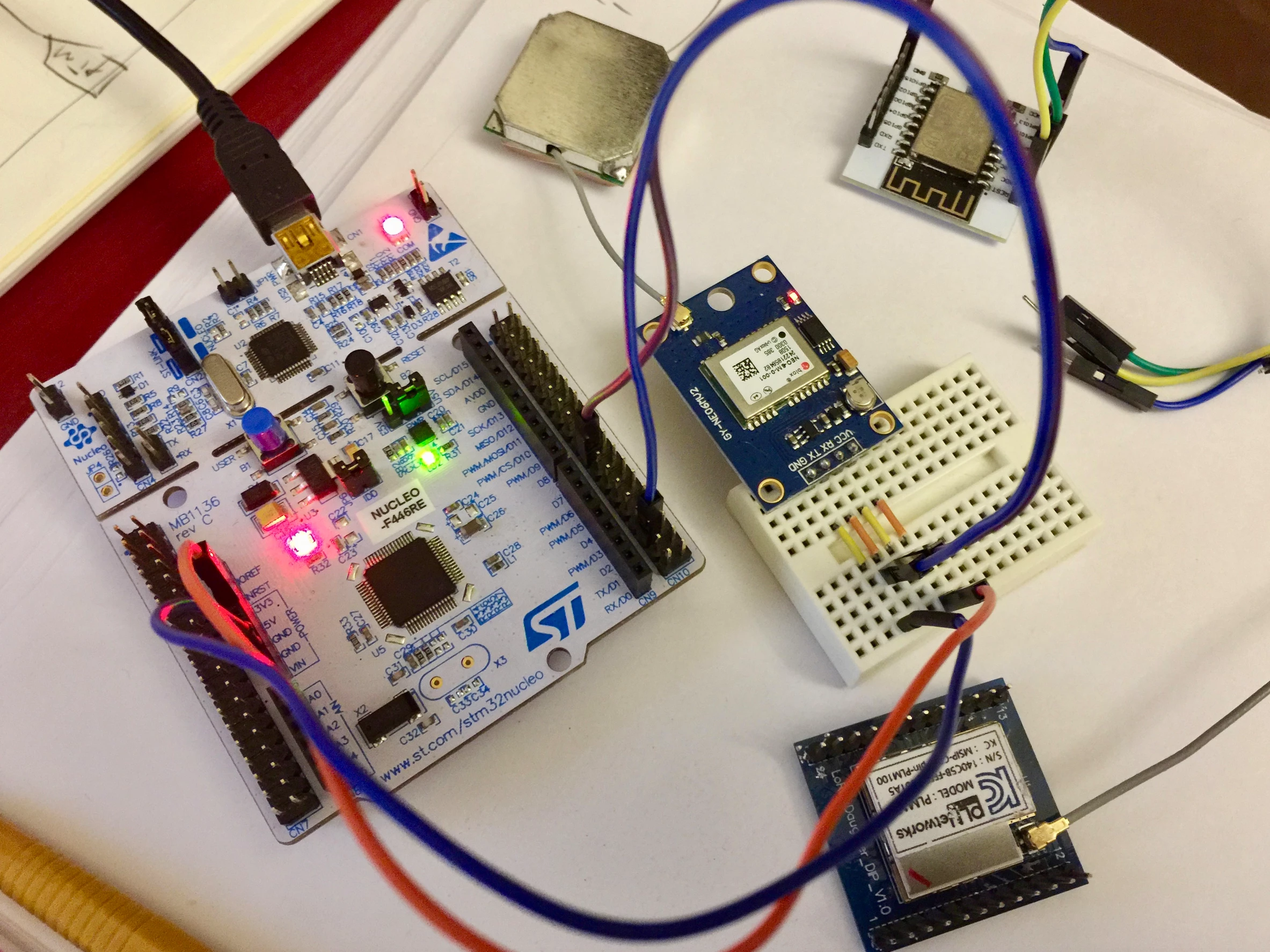

I tested three devices all day long today.
All devices are connected to the USART, but the incoming interrupt does not work at all.
A program that connects the Lo Ra modules, GPS modules, and wifi modules to USART 1 and outputs the data sent to USART 2.
However, the Rx Interrupt does not work at all.
Attach the project file.

    Does receive work in polled mode? Can you confirm signal performance on a scope?
    Not sure I'd be calling a blocking function like HAL_UART_Transmit() with a 1 second timeout in a callback.

    I'm not an advocate for the HAL library, but I can tell you from experience the USARTs on these boards function properly. The USART1 PA9/PA10 is not connected suitably on the STM32F4-DISCO to work properly. On that board I use uBlox GPS connected on USART2 PD5/PD6
    To debug USART issues you need to check signals with a scope, and review if RXNE asserts, or other error states are signalled and need clearing.
    It is critical that code in callbacks should not block, because otherwise data loss is bound to occur on one or more interfaces.

    You have blocking transmits in both uart1 and uart2 interrupt handlers.
    Have you done a simpler project to test if you can send and rec (no interrupts) to USB via uart2?
    are your solder bridges on the Nucleo correct for pa2/pa3 to the stlink?

    Ok. You say it doesn't work, or your don't get interrupts.
    You don't have anything in you main loop to see if its still running.
    You don't have an error handler for the Uarts.
    I am going to bet you end up with something if you add this and a breakpoint
    volatile uint32_t usarterror;
    void HAL_UART_ErrorCallback(UART_HandleTypeDef *huart)
    usarterror = HAL_UART_GetError(huart);
    // see errors on line 207-212 of stm32f4xx_hal_uart.h
    _Error_Handler(__FILE__, __LINE__);
