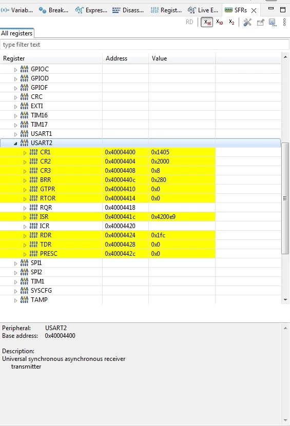

waclawek.jan
Dec 2, 2024 5:30 PM UTC
Read out and check/post the UART registers content. Check the real system clock, too, and by that I don't mean just to look at what you've clicked in CubeMX, but actually measure it in some way. One good way to do that may be to transmit some pattern e.g. 0b0101010101 through the UART (with disconnected other transmitter of course), and observe using oscilloscope/LA.
Robert Ritchey
Senior
Dec 2, 2024 7:30 PM UTC
I checked the clock, it is 64MHz.  I did it by configuring a timer channel to divide the system clock by 16 and output a square wave.  It showed a 250nsec period, or 16 MHz.  I also captured the USART registers.  They look fine but I am posting them.

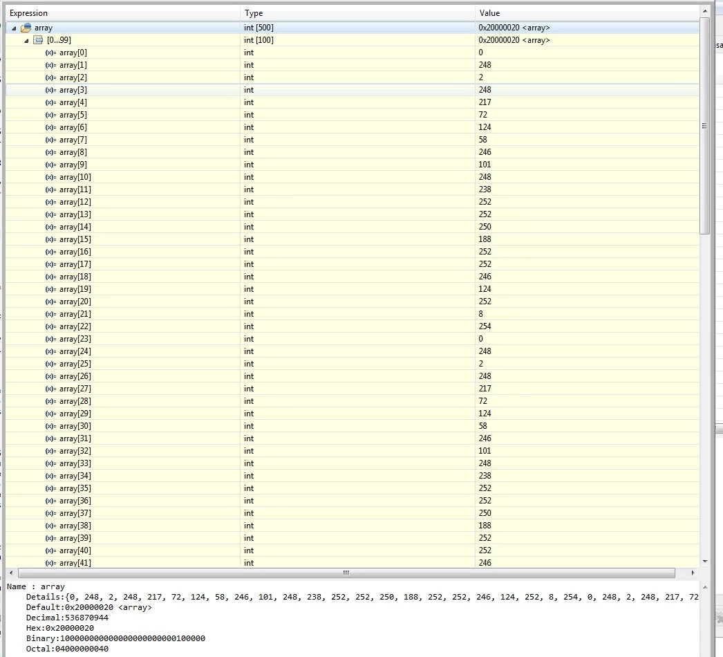

Robert Ritchey
Senior
Dec 3, 2024 8:08 PM UTC
By the way, here are some of the values I have captured.  You can see its repeating, just not the right values.  Also, do either of you know if the IDLE bit is set when it's not set to interrupt?  It doesn't say.  I keep expecting to see an IDLE when I am polling but it does not seem to get set.

Robert Ritchey
Senior
Dec 4, 2024 8:48 PM UTC
Thanks for stick with me though this.  The data was inverted.  I misread the documentation.  It's confusing as to what the USART expects.
Bit 16 RXINV: RX pin active level inversion
This bit is set and cleared by software.
0: RX pin signal works using the standard logic levels (VDD =1/idle, Gnd=0/mark)
1: RX pin signal values are inverted (VDD =0/mark, Gnd=1/idle).
