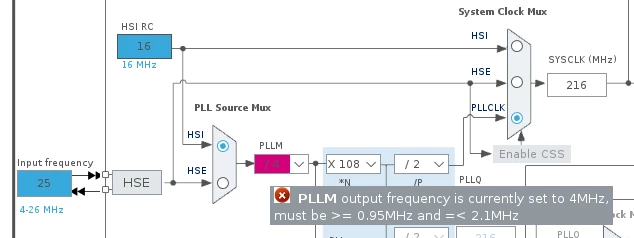

I am new on STM32 and I started a product prototype using STM32F769-Discovery. I developed all software using default clock configuration, which uses HSE.
Now I want to change to HSI, but USART is not working ( Not true, only works when board resets after downloading the program. When I disconnect USB cable and reconnect it, USART does not work anymore).
Below can find default config and my HSI config:

My config, not working (Using HSI):
* The system Clock is configured as follow :
* System Clock source = PLL (HSI)
* SYSCLK(Hz) = 216000000
* HCLK(Hz) = 216000000
* AHB Prescaler = 1
* APB1 Prescaler = 4
* APB2 Prescaler = 2
* HSI Frequency(Hz) = 16000000
* PLL_M = 4
* PLL_N = 108
* PLL_P = 2
* PLL_Q = 9
* PLL_R = 7
* VDD(V) = 3.3
* Main regulator output voltage = Scale1 mode
* Flash Latency(WS) = 7

Any idea of what could be happening?

berendi
Principal
May 6, 2020
Try it with PLLM=8 and PLLN=216 instead, adjust PLLSAIN too.

Ok, now I got:
PLLM = 8;
PLLN = 216;
PLLSAIN = 182
With these values I have fixed some issues of the GUI application running on the MCU, but USART keeps not working.
Any idea?
Kind Regards,
RCres.1
RCres.1Author
May 19, 2020
Hi, with current clock configuration, USART keeps not working.
Any idea?
* System Clock Configuration
* AHB Prescaler = 1
* PLL_M = 8
* PLL_N = 216
* PLL_P = 2
* PLL_Q = 9
* PLL_R = 7
* VDD(V) = 3.3
Kind Regards
