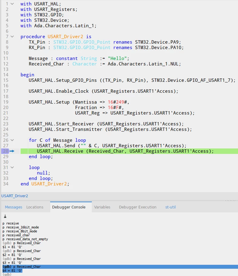

Hi 👋
I have implemented a simple program to send and receive characters over the USART device which works as expected when I connect my MCU up to minicom via usb as in I can see the characters sent by the program getting printed on the console and I can see the characters I type on minicom in the relevant variable in gdb.
Next, I tried connecting the TX and RX pins together to have transmission and reception in loopback mode but that doesn’t seem to work. My program (which does both transmission and reception in simple polling mode) simply gets stuck on the RXNE != 1 loop and never exits that indicating that the RX pin either never receives any data or it never detects a start bit so it just remains at the idle state waiting for that. So, I’m wondering what the reason for this might be..could it be that minicom simply sends the right start bit sequence which the Receiver picks-up? Or something else..?
The program in both cases is exactly the same so the only difference is that in loopback mode the two pins are naturally jumpered.
Also, within the tight loop the USART_SR register has the following (constant) content:
0x40011000:    11000000    00000000    00000000    00000000
Any thoughts? I am on an STM32F4 MCU and using the USART1 (if that makes any difference).
Thanks!

Yes, I do - See code below (it’s in Ada but should be fairly straightforward to follow, let me know if not):
procedure Receive (C         : out Character ;
                                USART_Reg : USART_Registers.USART_Reg_Acc) is
   begin
      loop
         exit when USART_Reg.USART_SR.RXNE; --   Line 1
         if USART_Reg.USART_SR.ORE then -- Line 2
            --   ORE reset sequence
            declare
               Unused1 : Boolean;
               Unused2 : HAL.UInt9;
            begin
               Unused1 := USART_Reg.USART_SR.PE;
               Unused2 := USART_Reg.USART_DR.DR;
            end;
         end if;
      end loop;
      C := Character'Val (USART_Reg.USART_DR.DR);
   end Receive;
Stepping through in gdb the flow effectively alternates between Line 1 and Line 2 without getting into the if so no overflow seems to be happening.

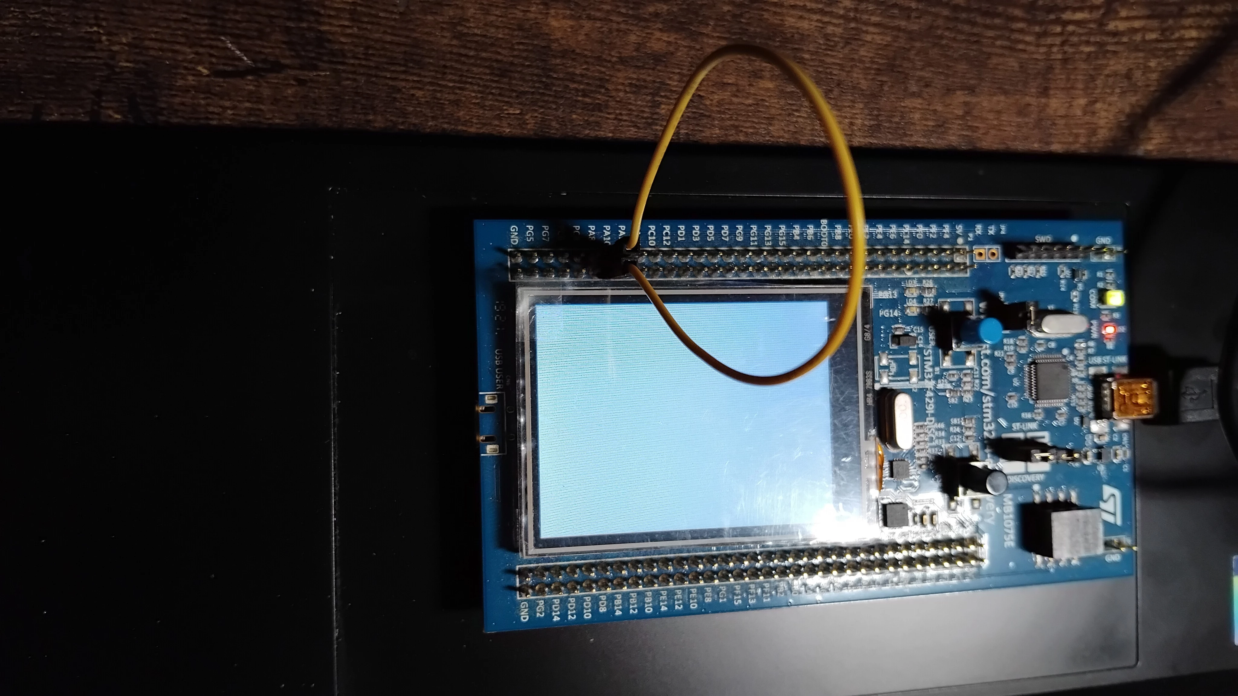

Alrighty, let’s look closer at the hardware.  How exactly are you creating your loopback?  Schematic and photos (for ​@Andrew Neil  ;-) will possibly be helpful.
David Littell
Senior II
Aug 5, 2026 1:40 PM UTC
I just re-read an earlier reply (thanks, forum, for still collapsing replies - NOT!) and noticed that the OP said he’s jumpering PA9 and PA10 to create the loopback.  If the MCU’s RX signal is still connected to anything it’ll be forced to the idle state by that device and the MCU’s TX won’t be able to overcome it.
Aug 5, 2026 9:11 PM UTC
hmm..don’t believe the RX pin connected to anything 🤔 it’s just set-up for alternate function, Pull_Up, Speed_50MHz, Push_Pull and it is jumpered to the TX pin via a rather large jumper wire..wonder if that somehow results in a noisy line..

Aug 6, 2026 9:05 PM UTC
I hesitate to do that because my code is in Ada and that’s why I’ve been focusing on the mcu aspect and the fact that this works on minicom..but if you fancy reading a bit of Ada then the following is the full code (excluding the hal layer of course for brevity) 🙂:
The above is a run against minicom where, if you see on the debugger console a bit further down, ‘Q’ has been received fine which is what I typed on minicom (I just pressed enter a few times hence you see this printed multiple times).
Transmitting also works as the characters of Message are getting printed fine:
But the exact same code breaks when I jumper PA9 & PA10 (as in the USART_SR.RXNE bit never goes high so Receive just spins forever)..so something in loopback mode it doesn’t like.
