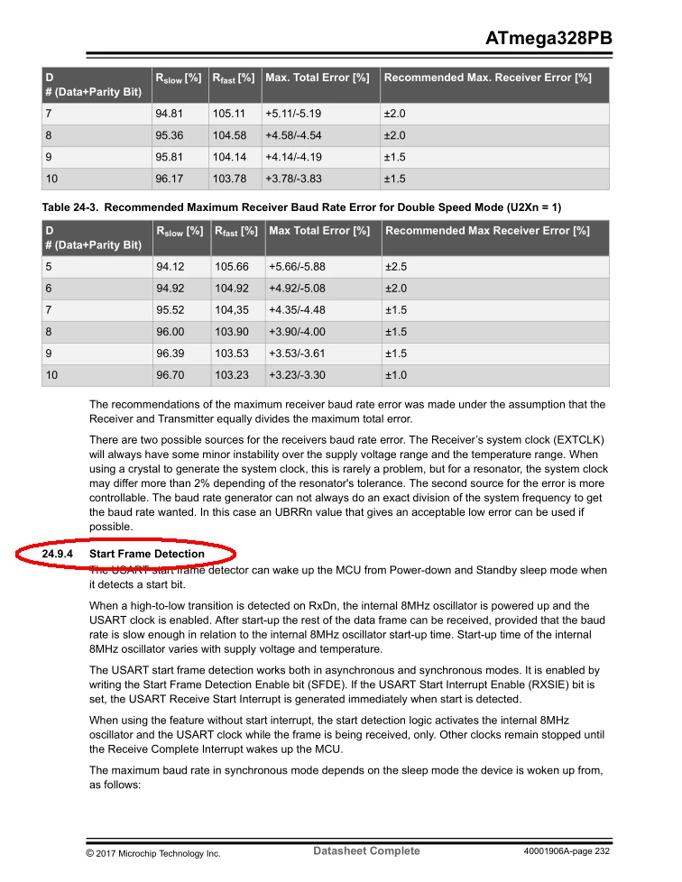

USART frame detect IRQ. How?
I'm modifying code for a Atmega AVR to a STM32L03 and encounter ISR(USART1_START_vect). It is a function that is called when the UART receives a start frame. I'm a newbie to this STM32-processor but I have googled and checked in inc-files but I cannot find any suitable code. I'm using HAL for now.
Have anyone a suggestion?

I have two UART ports. Both can occupy an interpreter and each port sets a flag that says "I now own the interpreter". That flag is set in this ISR().
I suppose a Frame detect IRQ coming when the hardware pin change state.
Define "start frame".

I suppose a Frame detect IRQ coming when the hardware pin change state in the beginning of the transfer.

If it's this
0693W00000WLQbcQAH.pngthen as Clive said above, EXTI may be a direct equivalent. However, for the purpose you've described, IMO it's better to "flip the switch" upon reception of the first byte on given UART.

The note from 328PB is exactly what I want to happen in STM32-mcu.
And why cannot it be done when the data is received?

The interpreter library is written to handle only one UART port. The code includes detection of start and stop frames. If I do this detection outside the library functions, the impact will be too great. It is easier to hire the interpreter after the first byte has arrived and continue to feed the interpreter with more data until the entire message is processed. After that the flag is reset and the respective UART buffer is checked if more data has arrived.

You are probably right. I can set the flag after the first byte has been received. The uart-ports has their own buffer but there is only one input buffer for the interpreter. I can set the flag in Rx-complete IRQ for the specific port.
Thanx. It is a simple solution and I get less IRQ:s.
