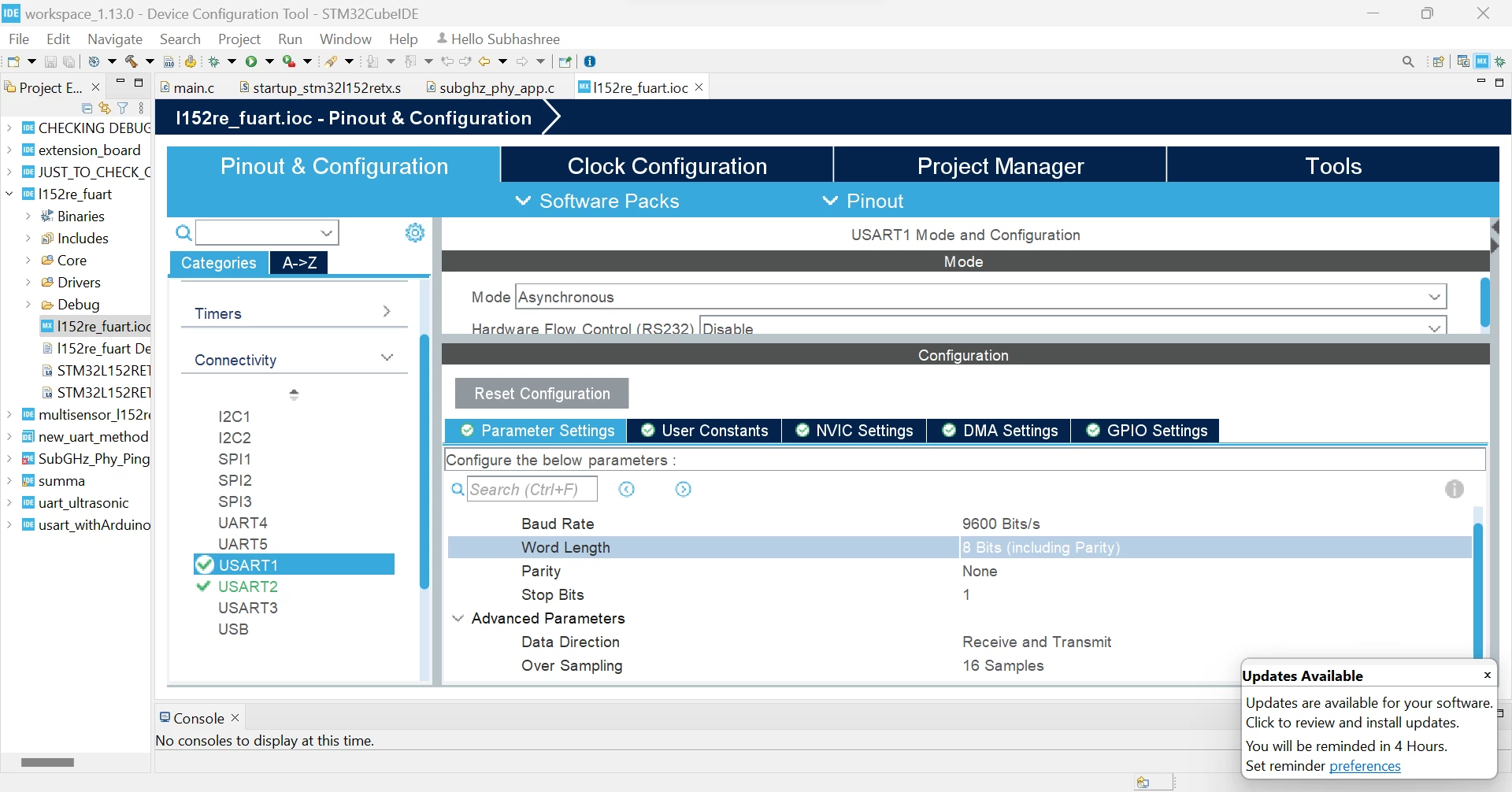

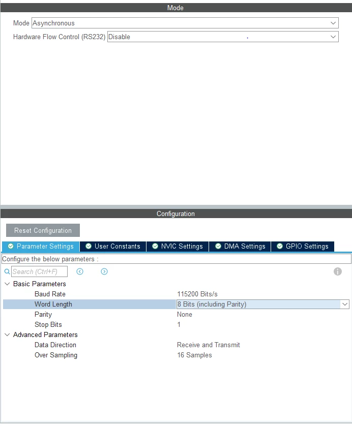

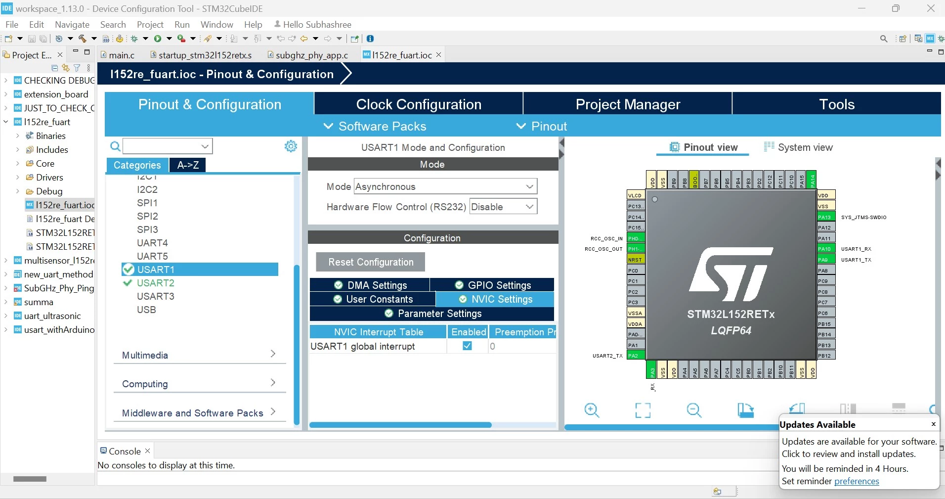

This is how I configured the port.

Yes, the USART settings of the NUCLEO matches

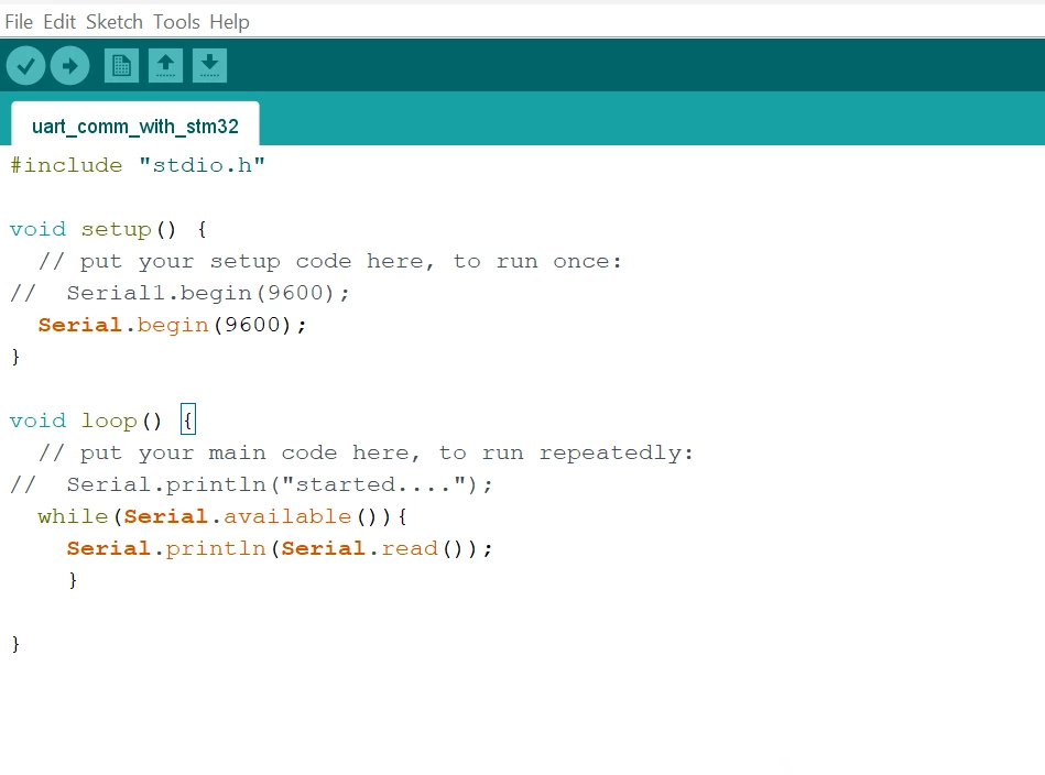

And the following is my Arduino code (I used the same code which worked for STM32WL)

We don't know about other Arduino UART settings: parity, word length etc..
As you already succeeded to communicate with STM32WL, are you sure you had set the same UART parameters for STM32L152 device as for STM32WL? i.e. parity, word length etc ?
Also you need to double check your hardware. Are you sure you have connected UART pins to the right IOs with a common GND?

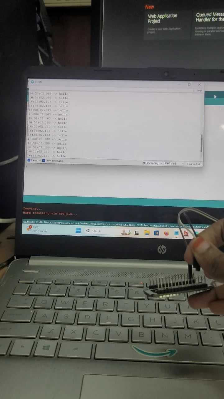

Yes the STM Code is fine because I tried the same lines for STM32WL55 board, and instead of Arduino UNO I tried with ESP8266 NodeMCU it works fine.
And I used the same code for STM32L152RE code and connected the STM board with ESP8266, which uses 3.3V logic. When the RX and TX lines are connected with the ESP8266 there is no Serial output it is just stuck
but when I remove the RX and TX wires the output is printed that it received when it was connected.

Forward out a different Serial port.
Serial is presumably the USB Serial of the Arduino.
Define the port and pins used by the Arduino for the connectivity you're complaining about.
