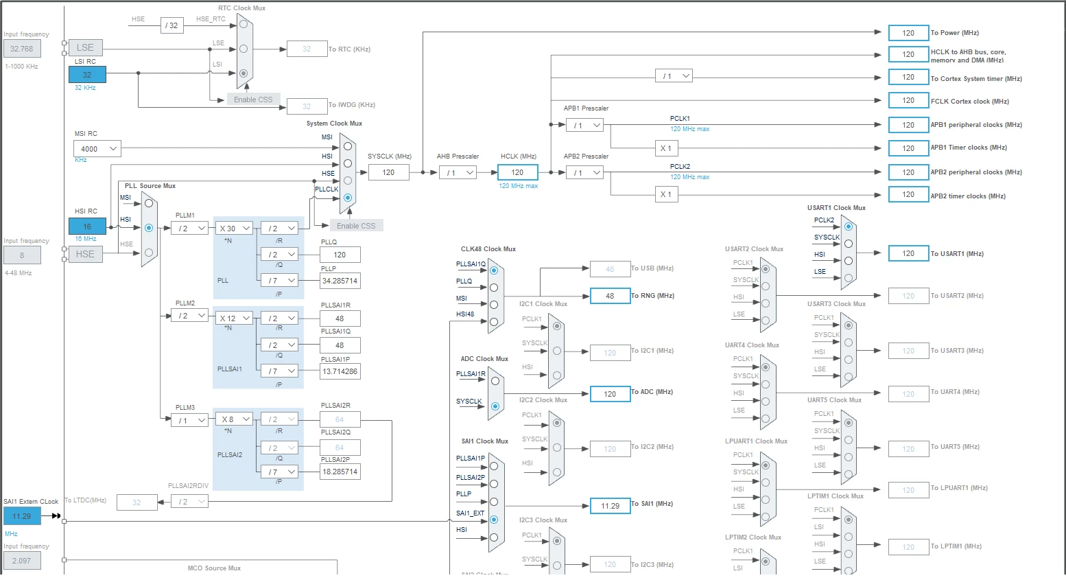

November 26, 2020
This is the clock config I have in CubeMX
