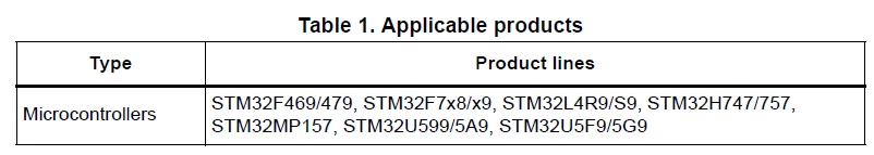

DSI: see details in this AN4860 Introduction to DSI host on STM32 MCUs and MPUs:

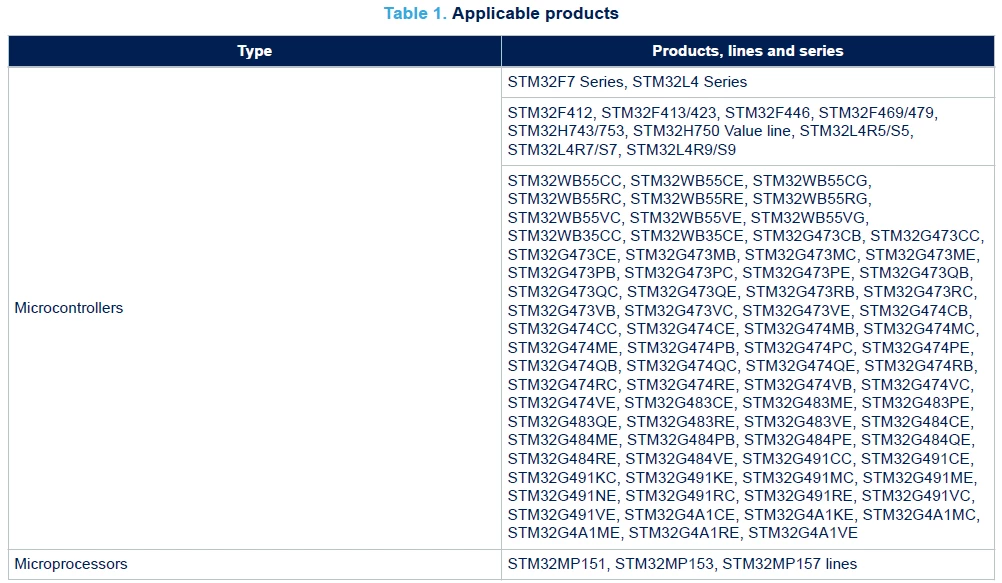

QSPI: see details in this AN4760 Quad-SPI interface on STM32 microcontrollers and microprocessors

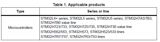

OCTOSPI: see details in this AN5050 Getting started with Octo-SPI, Hexadeca-SPI, and XSPI interfaces on STM32 MCUs
