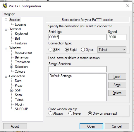

May 16, 2024
Sorry the system didn't allow to send more messages @Karl Yamashita
I use Putty and this is the settings:
I use "\t" so there is a tab space between measurement.
