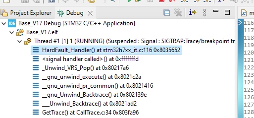

Hi
I would like to store the call stack when the STM32H7 crashes. I implemented unwind.h
The code works on a bare metal  simple est code but not with   FreeRTOS is running
Any idea as to why?
The code
static uint16_t CallStackAddr;
CALLSTACK_DATA uint32_t Address[MaxCallDepth];
_Unwind_Reason_Code trace_func(struct _Unwind_Context *context, void *arg)
void *ip = (void *)_Unwind_GetIP(context);
Address[CallStackAddr] = (uint32_t) ip;
if(CallStackAddr < MaxCallDepth)
CallStackAddr++;
return _URC_NO_REASON;
void GetTrace(void)
__disable_irq();
_Unwind_Reason_Code ret = _Unwind_Backtrace((_Unwind_Trace_Fn)&trace_func, NULL);
Address[CallStackAddr] = 0xF0F0F0F0;
