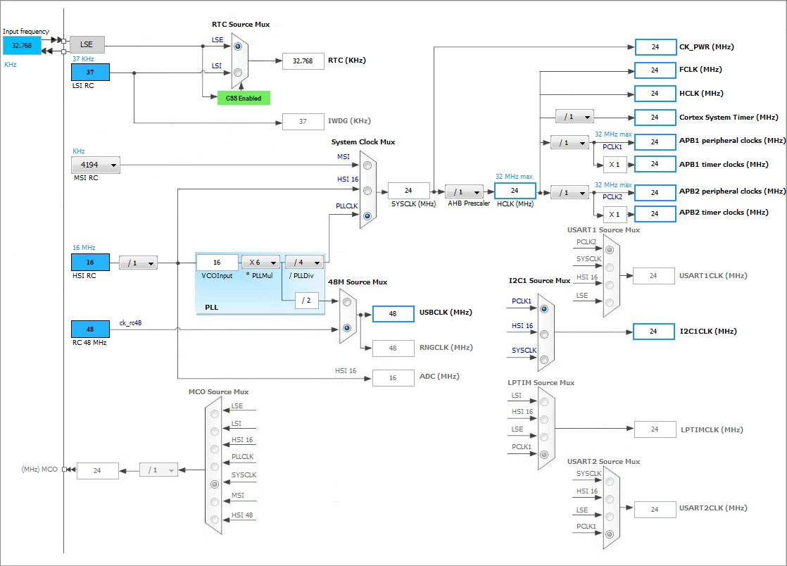

    UPDATE:
    (Note: This happens only after the first startup. If I power the device down and back up, evetything works)
    1.Program executes
    HAL_PWR_EnterSTOPMode();
    2.The processor does not go to STOPMode and goes straight to another function which is
    SystemClock_Config();
    3.I get HAL_TIMEOUT @ stm32l0xx_hal_rcc.c line 695
    while(__HAL_RCC_GET_FLAG(RCC_FLAG_HSI48RDY) == RESET)
       if((HAL_GetTick() - tickstart) > HSI48_TIMEOUT_VALUE)
          return HAL_TIMEOUT;
    Attaching my clock configuration below (supply voltage 2.2V):
    Nesrine M_O
    Nesrine M_OBest answer
    Jun 13, 2017 10:52 AM UTC
    Posted on June 13, 2017 at 10:52
    Hi
    Try to disable the
    Systick interrupt
    /* Enter Stop Mode */HAL_SuspendTick();HAL_PWR_EnterSTOPMode(PWR_LOWPOWERREGULATOR_ON, PWR_STOPENTRY_WFI);HAL_ResumeTick();�?�?�?�?
    -Nesrine-
    Michal Dubovsky
    Jun 13, 2017 11:18 AM UTC
    Posted on June 13, 2017 at 11:18
    This totally works. I can't find a reason why this isn't mentioned in the example or in a HAL_PWR_EnterSTOPMode() function description.
