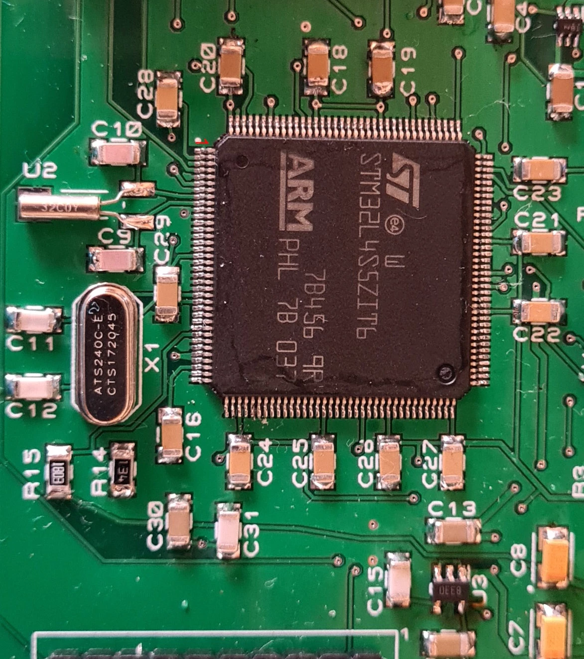

VVest.1
VVest.1Author
April 3, 2021
Thank you all for your answers. Just a sanity check that the orientation is correct? I'm 99% sure it is but anyhow. In the picture top left corner pin 1 and from there ccw numbering goes. Thank you in advance.0693W000008yd07QAA.jpg
Uwe Bonnes
Chief
April 3, 2021
That is right. With the text visible normal, Pin 1 is left bottom

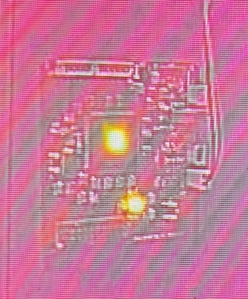

VVest.1
VVest.1Author
April 3, 2021
I already soldered the 3.3V regulator back so it is the other one heating here (lower right corner) due to the huge power the UC is draining. Like you can see the middle of the UC heats up and it heats up quickly. Sorry for the crappy image, my thermal camera just didn't want to communicate with pc so took a picture of the screen..0693W000008ydNzQAI.jpg
