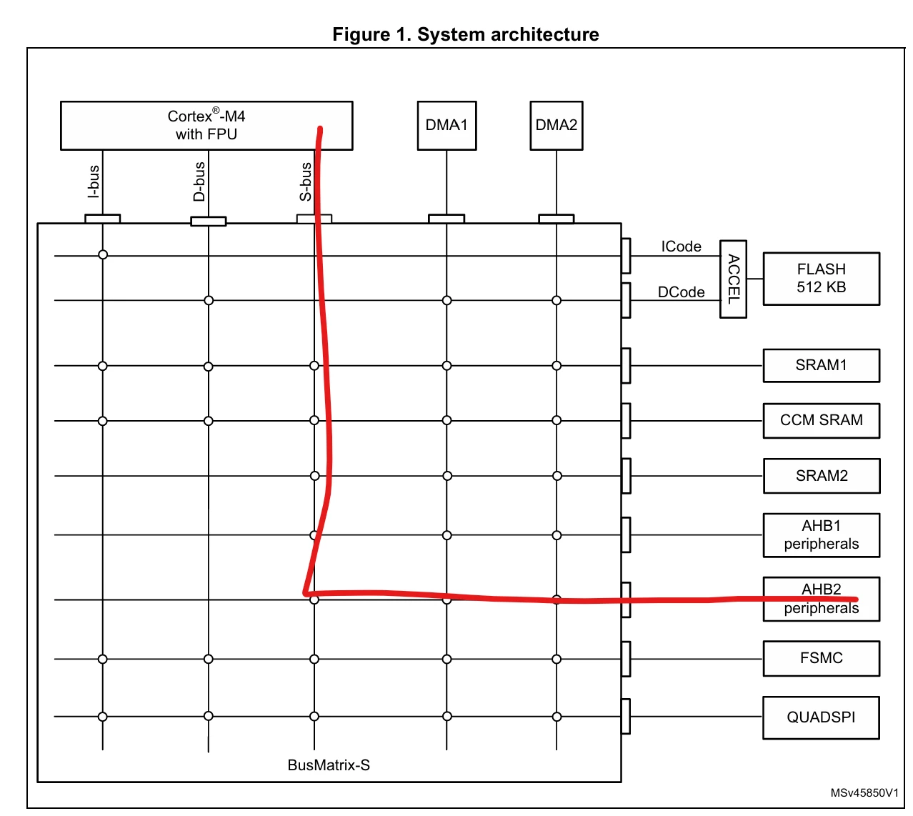

works, has only a 1 cycle jitter (way better than the 5 cycle using the loop), BUT I see the signal rise on the GPIO only 10 cycles after the event I wait for. From what I currently understand, WFE should exit one cycle after the event and STR should take 3 cycles.
I guess the event take some time to be raised, maybe also the pipeline needs to be reloaded after the WFE, but have not found the information in the reference manuals yet.
Jan 3, 2026 4:18 PM UTC
Writes are not instant. There is a bus which carries data through the system to where it needs to go, in this case it needs to go from the CPU to AHB2 where the GPIOs are. This takes more time. When the write actually occurs, the CPU is processing other instructions. Use DSB to enforce barriers between writes if it is important that X happens before Y.
Having the debugger active at the same time can also disrupts timing within the system.
Toggling pins with the CPU is not a good way to get precise timing. There are a variety of peripherals such as SPI or TIM that can do this with tick-level precision.
