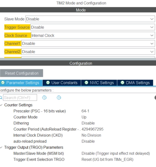

I have a small problem when using a custom delay function as follows :
void delay_us(uint32_t delayus) {
uint32_t start_count = __HAL_TIM_GET_COUNTER(&htim2);
while ((__HAL_TIM_GET_COUNTER(&htim2) - start_count) < delayus) {
 The attached image shows the configuration of timer 2.
This delay function should allow me to generate short pulses. except that sometimes it does and sometimes nothing happens when I use it. I don't know what the problem is. Could you please help me?

Interrupt  can be a reason for longer delay, or hal funtion do something

you should not use some HAL lib calls , if you expect "us" timing, HAL might need 1 us itself .
And why on 32 bit counter ? need more than 60ms delay ? then use HAL_delay () .
I would try : (on TIM3)
 TIM3->CNT = 0x0000 ; // start_count
 while ((TIM3->CNT) < delayus) { };

the 32 bit counter was in the tutorial I followed on youtube.
why timer 3 and not timer 2?

Please give a link to that tutorial
What do you mean by, "nothing happens"?
  • There is no delay?
  • Your system hangs?
  • other ... ?

Default promotion to  INT.
LadyMtAuthor
May 13, 2024
I'm starting out in stm32 and unfortunately I don't understand what you're trying to point out. Could you be clearer? Please.
Radosław
May 13, 2024
AGAIN  propotion to int
Test your conditions

while (((uint32_t)(__HAL_TIM_GET_COUNTER(&htim2) - start_count)) < delayus) {
and ARR of timer must be 0xFFFFFFFF

Promotion to int and
Even with this modification it still works randomly
