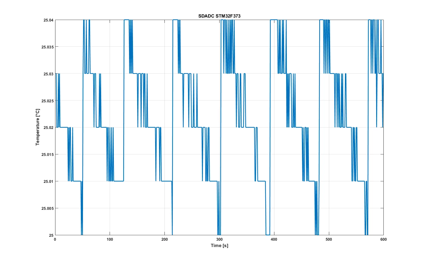

For a 21-channel temperature measurement tool (NTCs) I use a STM32F373 ( SDADC1 + SDADC2 + SDADC3). I replaced a temperature sensor with a fixed resistor for these tests.

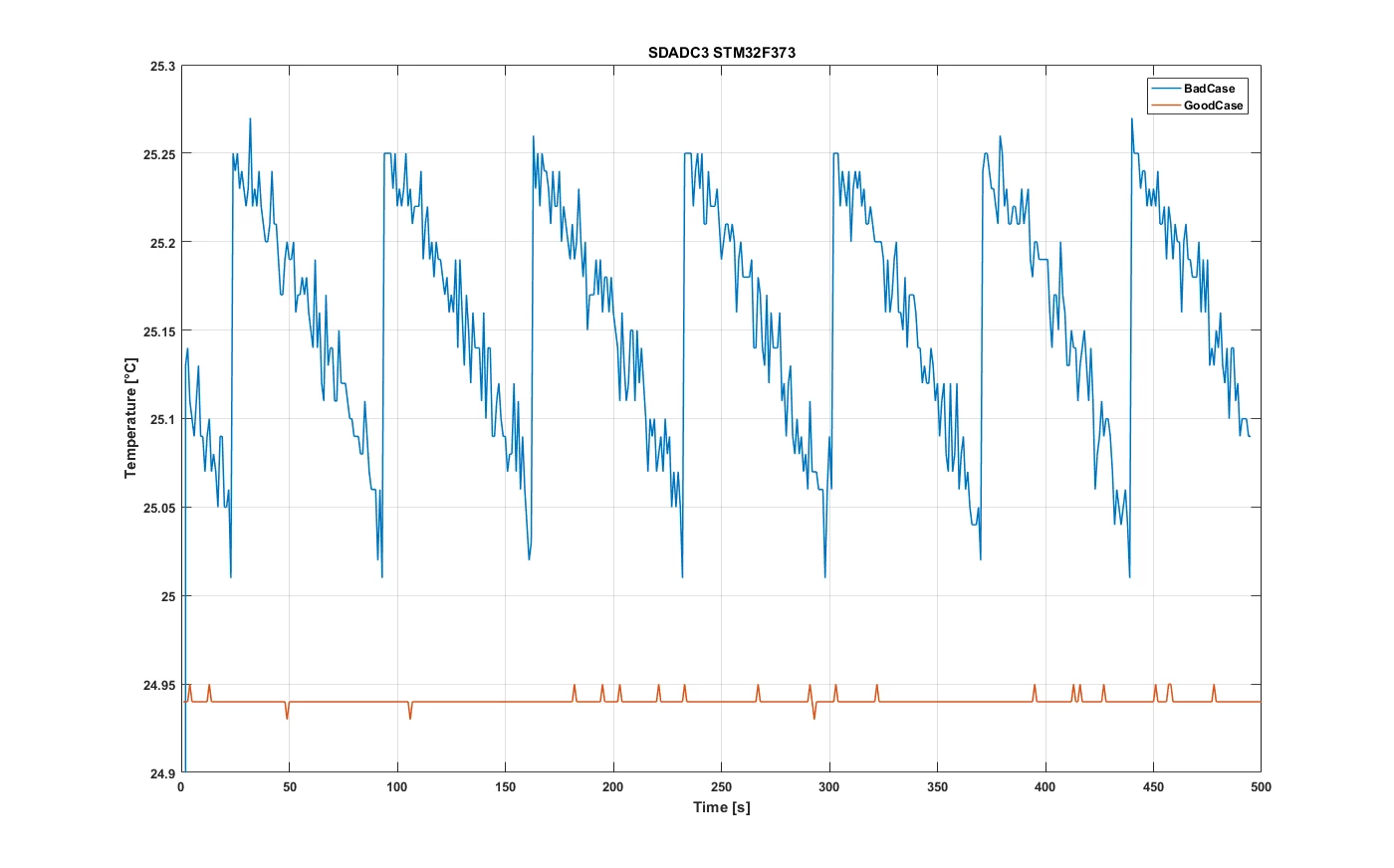

The behavior of the ADCs is different and reproducible after startup:
Good Case: The measured values are absolutely stable and correspond to the setpoint
Bad Case: The measured values are not stable and shift with a time constant of approx. 80 seconds. The behaviour of all 3 SDADCs are the same.

    After starting up, the SDADC either works stable "good case" or with a drift "bad case". This behavior is maintained throughout the operating period. The chance that the SDADC works correctly is fifty-fifty. I suspect that the SDADC has a timing problem.
    Were-Rabbit
    August 6, 2018
    I have switched the Syclk to HSE and the ADC now provides reproducible values. The drift has dropped markedly but the jumps every 60 seconds is still noticeable. Does the processor perform additional automatic calibrations?
