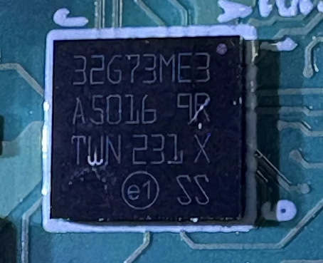

I can't decipher the silkscreen markings on this chip. Could you please help me confirm?
This chip looks like it's from ST, but I didn't see the ST logo.
I suspect it's an abbreviation for STM32G473ME, but I can't confirm it, and the chip's datasheet doesn't provide detailed information on device markings.

Yes, the marking 32G73ME3 stands for the STM32G473MEY3TR.
Hope that helps?

Thank you so much for confirming this for me. No further assistance is needed; you've already done me a huge favor.

9R is TSMC Fab 14 in Taiwan
Packaging also in Taiwan (TWN)
