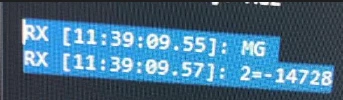

Hi, I'm having a problem with unintentionally splitting a message I'm trying to send over the UART using DMA . I am using one function to send the message:

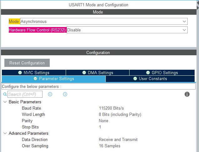

Not every message is split, moreover 99% of messages are sent without any problems, but sometimes messages are split into two parts and I don't see the dependency when this happens. I don't use RTOS.

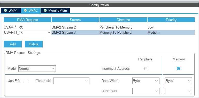

I'm using this DMA only for this UART, but also for TX and RX, at first I thought the RX stream was interrupting the TX stream, but I set the TX stream priority to DMA_PRIORITY_MEDIUM where RX has DMA_PRIORITY_LOW and that didn't help.
UART and DMA configuration:
Examples of splitting messages:
Unfortunately, I have no idea what can cause the fact that the significant majority of messages are sent correctly, but some are sent incorrectly. If you have any ideas, please help me with this issue.

Tesla DeLorean
Guru
September 25, 2023
Is it actually splitting it? Or is this how your receiver times out, buffers, or granularity/resolution there.
Check signals on a scope or logic analyzer.
Expect to have to reconstruct data, and resync, on the host. If there are no additional characters inserted, I'd look at other expectations and synchronization
grados73Author
September 28, 2023
Unfortunately, the problem hasn't gone away, but it didn't occur during my tests, so I can't solve it with an oscilloscope or logic analyzer. We think it may be a Windows problem with the handling of messages coming to the computer's COM port. This is now solved using the message joining procedure in the PC application, but this is a temporary solution. Hopefully, during the next tests, we will be able to catch this definitively and make sure that the problem is not on the STM side. By the way, the bug with the wrong place to check if the transmission is finished has been fixed, and I thank you for your help. If something is clarified I will write in the comment thread, maybe it will be useful to someone someday.
Tesla DeLorean
Guru
September 28, 2023
The STM32 with DMA to a USART should not have any significant inter-symbol gaps or pauses, the hardware is pretty simple/dumb so it's going to funnel data consistently, the bandwidth of the serial data being such that any contention is not going to be visible as you've got 8-10 bit times of slop.
What's definitely going to be an issue is the synchronization between the sender and the receiver, they are operating in entirely different time domains, so if one is collecting data say every 100ms to process, or busy with other tasks/threads, where a larger transfer might be bisected is anyone's guess. The receiving end will need to reassemble packets, and you'll want a format that's able to self-synchronize, and detect errors and corruption, and be able to recover. Expecting to send/receive a dozen bytes in lock-step, indefinitely is going to break.
