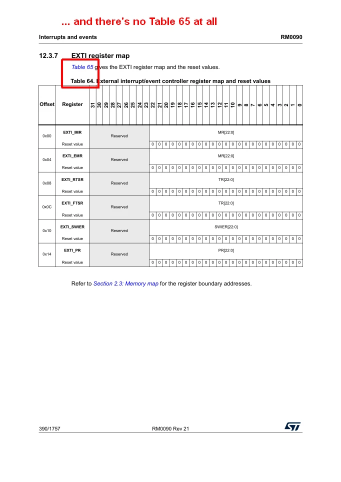

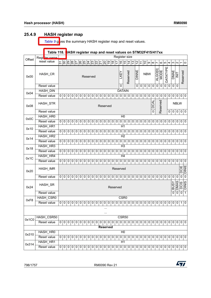

Hello @waclawek.jan @Andrew Neil ,
Thank you for bringing these typos to our attention.
I reported these typos and your feedback internally.
Internal ticket number CDM0062312 (This is an internal tracking number and is not accessible or usable by customers).
Thank you.
Kaouthar
3 replies
Andrew Neil
May 1, 2026 4:52 PM UTC
It has always seemed to me that having that text which simply repeats the title of the table verbatim is entirely pointless!
Just remove it - it adds no value, and is just a burden to update!
waclawek.jan
May 1, 2026 5:14 PM UTC
+1, simply removing it is the right solution IMO; and already used in some chapters here and most in the newer RMs.
