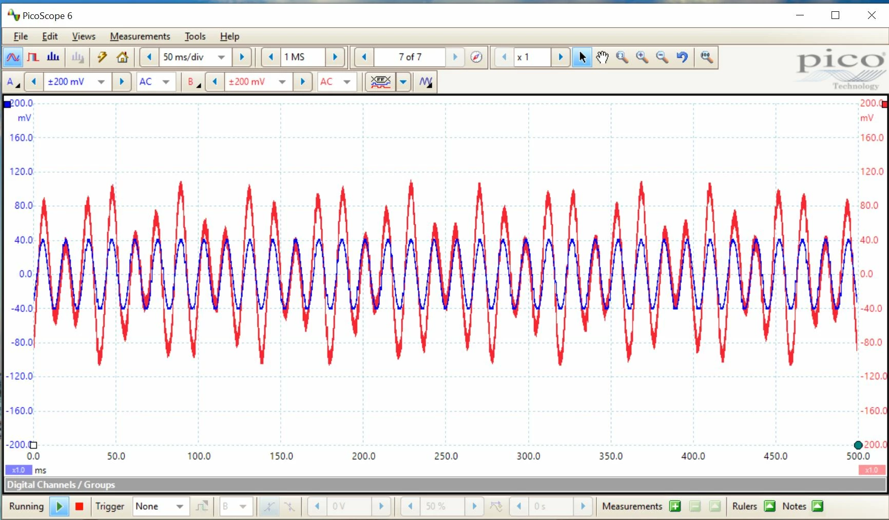

I try to learn how to use OPAMP by testing the example code Examples/OPAMP/OPAMP_PGA/.
The MCU board is Nucleo-G431RB.
0693W00000DntA6QAJ.jpgThis is the case of OPAMP_PGA_GAIN_2_OR_MINUS_1: blue line is output by DAC and red is by OPAMP.
My 1st question: why the amplified signal is distorted. Isn't it supposed to be another sine wave?

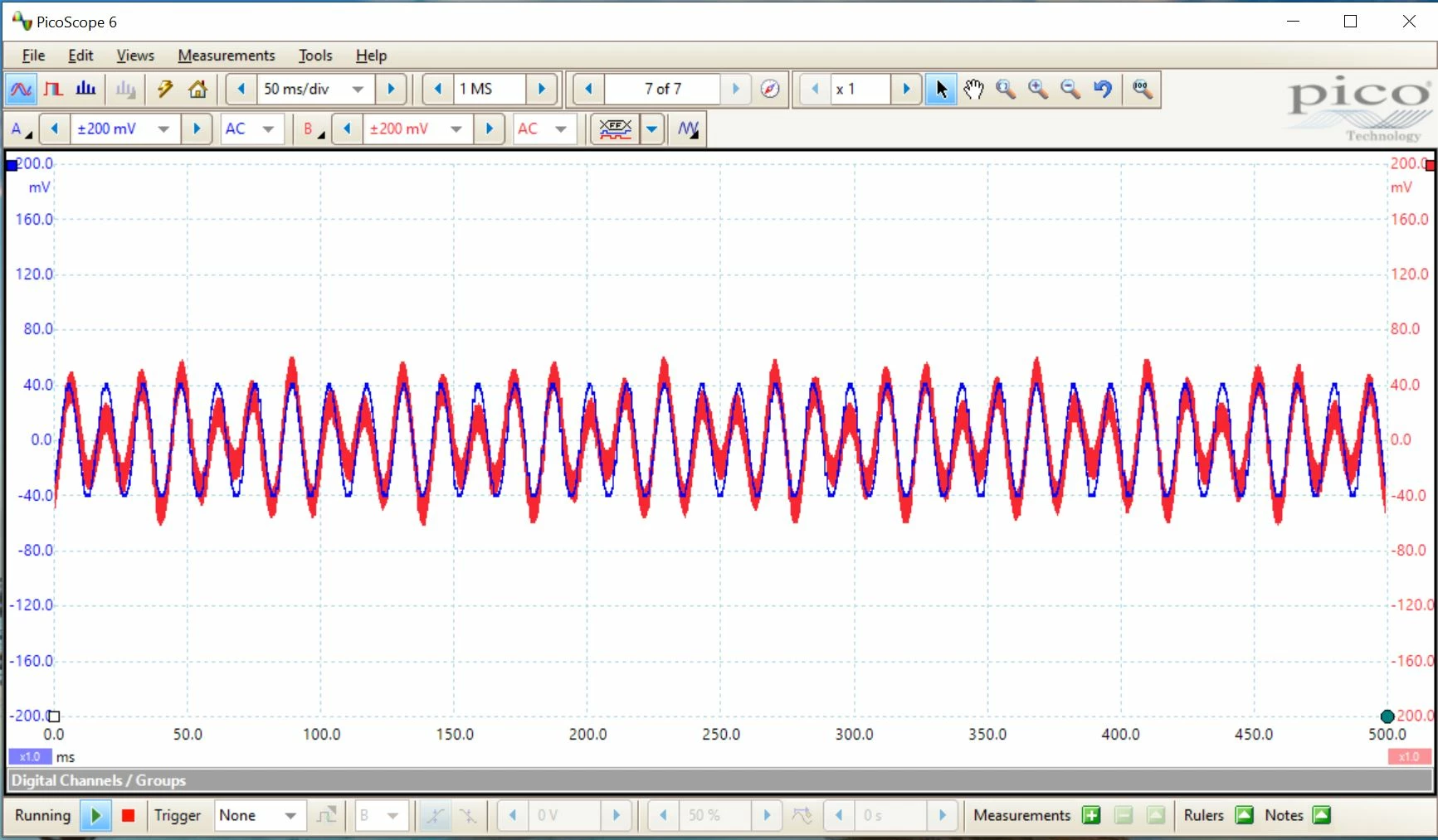

0693W00000DntCRQAZ.jpgThis is the case of OPAMP_PGA_GAIN_4_OR_MINUS_3.
My 2nd question: the amplitudes of the amplified signal seem not matching the gain.
Once the gain >= 8, the amplified signal becomes almost straight line. I also wonder why.

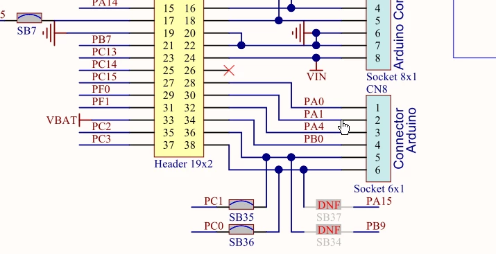

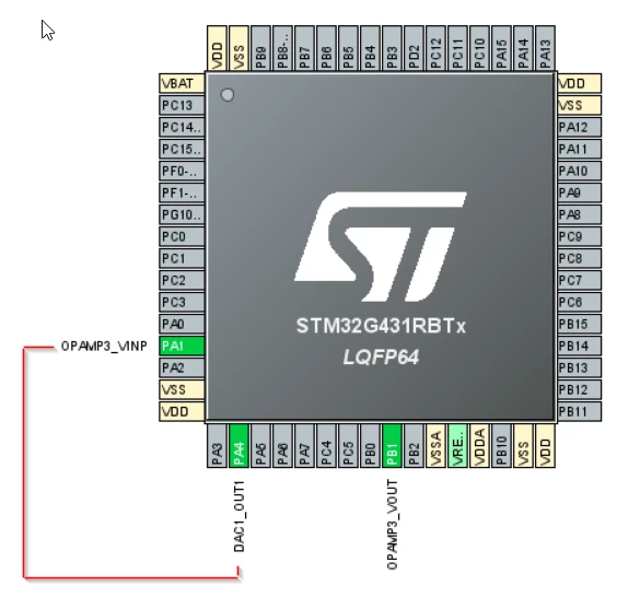

0693W00000FAJrZQAX.pngHi @HDaji.1 (Community Member)​ ,
Did you connect externally PA4 (DAC1_OUT1) to PA1 (OPAMP3_VINP)?
Those 2 pins must be connected together to sent signal from DAC to OPAMP. Those 2 pins are beside on Nucleo - so probably you didn't connect them together and there is only crosstalk from PA4 to PA1.

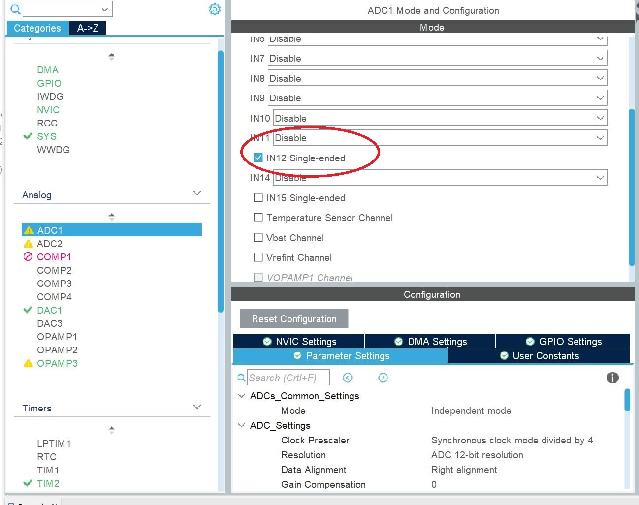

But I would like to come back to your last request I want to modify the example code: I want to route the OPAMP output internally to a ADC channel. What steps I need to do?
What is good with the examples in STM32CubeG4 is that you have an ioc file with the example.
You can use it to do some more configuration and add other peripherals.

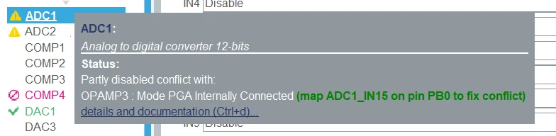

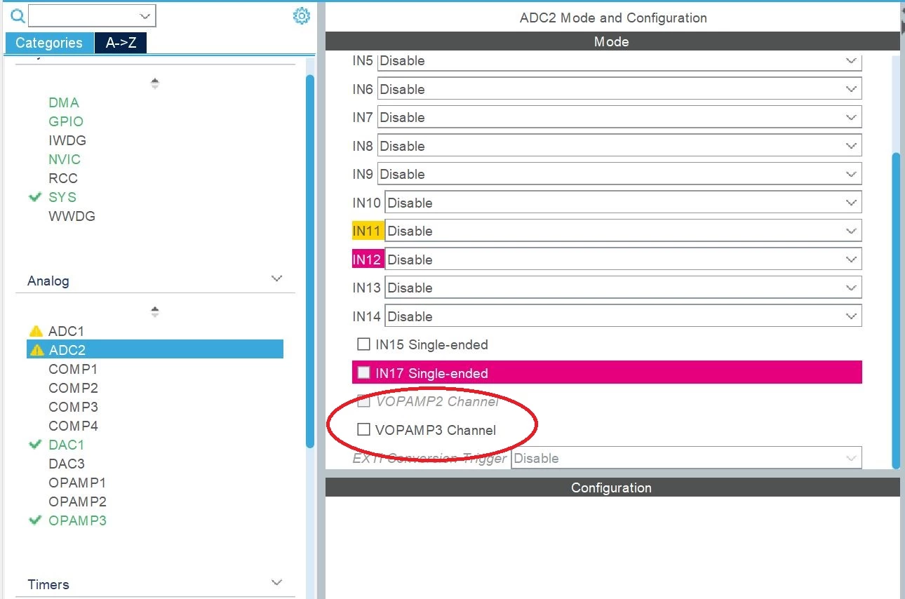

First thing to do in your case is to change OPAMP mode as "PGA Internally Connected" from STM32CubeMX configuration wizard.
Referring to the table "Operational amplifier possible connection" of the reference manual RM0440, you can see that OPMAP3_VOUT can be connected to ADC1_IN12 or ADC2_IN18 (on STM32G431RB).
If you hover over the cursor on ADC1 or ADC2, you will have a pop-up guiding you each time on the configuration to setup:
0693W00000FA8FdQAL.pngOnce the configuration is done, you can generate your project and the new setup will be added to initial project.
-Amel

0693W00000FAHrlQAH.jpg@Amel NASRI​
I checked IN12 Single-ended. Anything else?
And in ADC2 menu, I don't see IN18, instead it is sth like this:
Why is it different from ADC1?
Regards
Igor

September 25, 2021
@Igor Cesko​ Once I connect PA4 to PA1, I see amplified signal from PB1 (OPAMP3_OUT). Thx for the tip.
In the readme file, it says "Connect a wire between DAC output (PA4 - pin 32 on connector CN7) to OPAMP non inverting input (PB0 - pin 34 on connector CN7)". I guess it is wrong, isn't it?

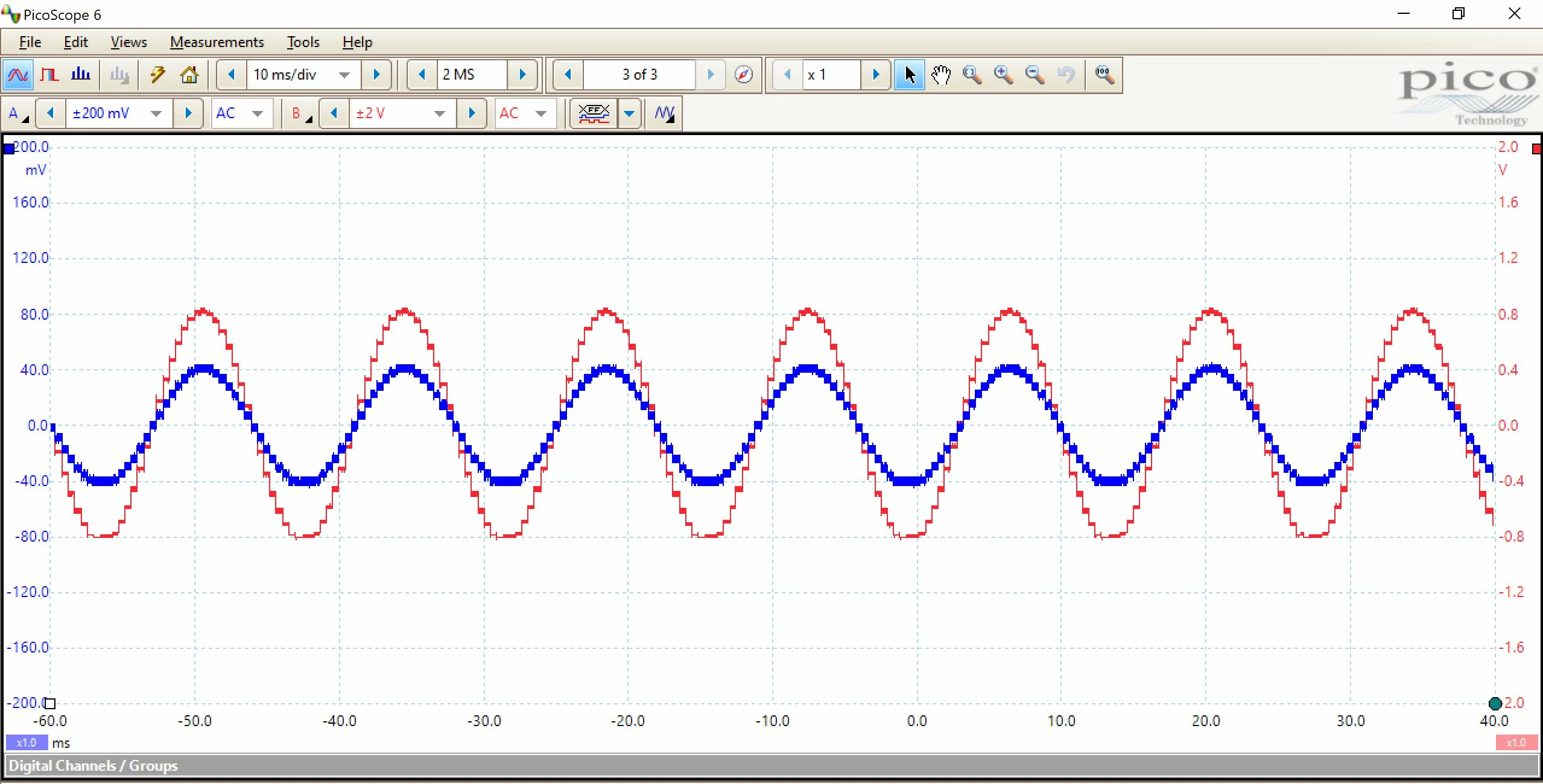

Dear @Igor Cesko​
I have another question:
0693W00000FARNMQA5.jpgThe above pic shows the signals captured from DAC and OPAMP output pins: blue is DAC; red OPAMP.
What puzzles me is their amplitudes: DAC output is from -40mv to 40mv; while OPAMP output is -0.8v to 0.8v. The gain is 20 times, but for OPAMP PGA setting is
 hopamp3.Init.PgaGain = OPAMP_PGA_GAIN_2_OR_MINUS_1;

September 28, 2021
@Igor Cesko​ sorry, my fault. The two probes themselves have 2 different gains: x1 & x10, so now everything makes sense.
