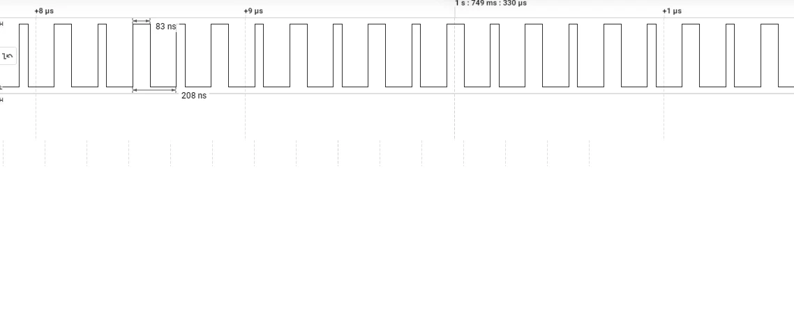

I am confused with pin toggle timings, why I am getting non equal pulse widths like in the picture, I turn off all compiler optimizations and disable all of the interrupts, code is simple pin toggling. My controller is STM32L431 running on 80MHz.
Thank you very much for any advice!

    KnarfB
    November 1, 2024
    Are you using one of those cheap logic analyzers with a sample rate of 24 MHz or lower?
    tompaAuthor
    November 1, 2024
    Hi KnarfB,
    Thank you for your reply, Yes I am using Saleae Logic with 24Ms/s and my signal is 500KHz so I don't think it is a problem. I also check the signal with 70MHz and 2GSa/s Keysight oscilloscope and result is the same...

    Perhaps stop doing things this way..
    First up, use HW resources, like the TIM to do stuff that is immune to the processor operating in saturation mode. Perhaps have that output as a direct constrast to the two methods, so you're sure you're observing what you think you're observing. As KnarfB points out, this could be a bandwidth/shannon/nyquist issue, some odd beat frequency because you're not observing it with enough bandwidth.
    If you're doing saturation mode, at least look at the generated code, or write it all in assembler.
    Unwind the loop, use registers/pointers for the interactions.
    Watch for how the pipelining, the write-buffers, and the FLASH line reading/caching interact.

    I tried to use DWT but still having unequal pulsee widths.

    Ok, so that advance compare isn't how to do this, you want to delta the measurements, and then compare the difference. That way wrapping is handled by the unsigned math directly.
    while ((DWT->CYCCNT - start) < 200);
    start += 200;
    The pipeline is multiple cycles long, the throughput at an instruction level might be 1, but the completion time is not.
    The writes occur asynchronously/later, most here have 2 write buffers, that get processed at bus speeds before they stall the execution pipeline awaiting completion. This is why Hard Faults can be "imprecise" you have to walk back the PC to find the offending STORE instruction when a WRITE fails.
    Several of the STM32 CM4 have a caching mechanism bolted outside the core, to the FLASH, the width of the FLASH and this cache can be quite wide, perhaps 64 or 128-bit wide, take the same 35ns, or so, to read the line vs a byte, or a word, but once cached the other parts of the line can be read/prefetched with no costs. The eviction mechanics and the branch alignment will impact how quickly each loop executes, assume it's not consistent. If you want more consistency, run code from RAM.
    The bus the GPIO is on is not operating in a single cycle, a write is going to take at least 4 cycles to complete.

    With 200 cycles I am getting 2.458us and sometimes 2.583us measured on Saleae Logic which is correct - I can see jitter on the scope...

    The while(1) is NOT zero overhead. To prove it, try

    @tompa wrote: "unfortunatelly still uneven widths.."
    I never said it would fix it, it would prove it... Was the proof correct?

    gregstm
    Senior II
    November 2, 2024
    Use a simulator and step through your code at the assembly level, counting the cycles (there should a cycle count visible) - that way you will get to see the "overhead" of the loop. If you want to handcraft a loop with precise timing, you could consider doing it in assembly language.
