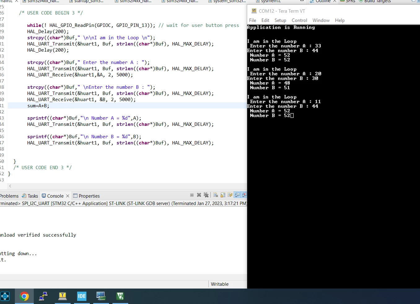

0693W00000Y9N0cQAF.pngBelow is my code:
uint8_t line[50]="Application is Running\n";
uint8_t Buf[50];
uint8_t A=0,B=0;
  while(! HAL_GPIO_ReadPin(GPIOC, GPIO_PIN_13)); // wait for user button press
  HAL_Delay(200);
  strcpy((char*)Buf," \n\nI am in the Loop \n");
  HAL_UART_Transmit(&huart1, Buf, strlen((char*)Buf), HAL_MAX_DELAY);
  HAL_Delay(200);
  strcpy((char*)Buf," Enter the number A : ");
  HAL_UART_Receive(&huart1,&A, 2, 5000);
  strcpy((char*)Buf," \nEnter the number B : ");
  HAL_UART_Receive(&huart1, &B, 2, 5000);
  sum=A+B;
  sprintf((char*)Buf,"\n Number A = %d",A);
  sprintf((char*)Buf,"\n Number B = %d",B);
I am getting unexpected output on serial monitor
what is wrong

1) UART_Receive reading two bytes and writes them into one byte variable -> that is dangerous mistake (array overflow)
2) If you are looking for way "to read numbers from terminal" you are confused about strings, ASCII codes and numbers. From UART you want to read strings (array of characters), then you have to convert it to numbers (by sscanf() or atoi() or atol() or another way) and then you can print these numbers by sprintf().

Thank you Michal, I really confused about that. I cleared it now but I have question, what if I want to store 40505600.56989 (frequency) in a variable by entering in a terminal
Michal Dudka
Lead
January 30, 2023
The same way as integer.
1) Receive string from UART (google "receiving strings UART STM32 HAL")
2) Then convert received string to floating point number for example by sscanf() or atof().

The output is at least partially expected. It's a miracle your program doesn't fail completely, since you are attempting to read 2 bytes into one-byte variable. I guess by pure luck A is placed in memory right after B, so while trying to receive two digits into B you actually read one digit into B and another into A, overwriting the previous value of A. ASCII code of digit n is 48+n, so the output is correct (48 -> digit 0, 51 - digit 3, 52 -> digit 4, etc.).
