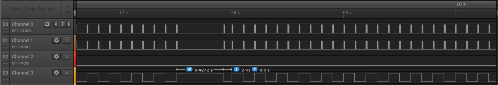

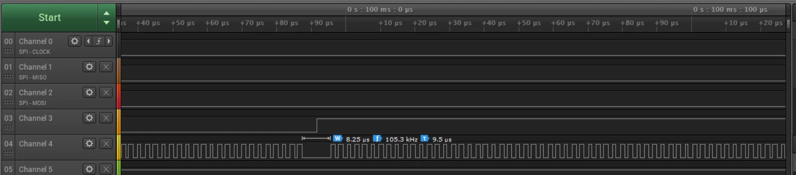

Hi ST community,
I am interrested in using the STM32F767-Nucleo board for SPI communication. My system is as follows. I have one STM32F767-Nucleo board which is my SPI slave and a Raspberry Pi which acts as SPI master device. The Raspi should read data via SPI from the Nucleo board. There is also one wire which is used from the Nucleo board to tell the Raspi when data is ready to be read. So every time data is ready the STM32 toggles this GPIO pin and the Raspi gets an interrupt and forces a read command.
Now my problem is not the SPI communication, no this works very well. The problem is the GPIO pin which forces interrupts at the Raspi and after that SPI read commands for the STM32. After some time of working properly the GPIO pin does nothing for about 400ms to 500ms and I don't know why this happens (see picture GPIO_stop_working.png) .
I use the DMA to transfer data from the memory to the SPI peripheral. If timer 3 generates an Interrupt (this happens every 100ms) HAL_TIM_PeriodElapsedCallback will be called. In the callback function I toggle GPIO pin PG2 which is the wire that tells the Raspi data are ready to be read. If the first timer interrupt occurs the STM32 will send only one number and after that at every timer interrupt data gets sent with HAL_SPI_Transmit_DMA.
My first idea was maybe the Raspi causes this discrepancy at GPIO PG2 but I replaced it with antother STM32F767-Nucleo board which has the same task as the Raspi and the same problem occurs. Therefore I think the problem is at the side of the Nucleo board and not the Raspi.
ps: The code from the STM32 is in the first reply of this post.
-Lukas

    Looks like it's stuck in another interrupt handler somewhere. The edge after the delay is delayed. Review your other interrupts to ensure none of them are blocking. If you're stuck, instrument SysTick handler to monitor the currently active interrupt to find out where the delay is happening.
    LBaum.3
    LBaum.3Author
    May 18, 2021 3:08 PM UTC
    Hi @TDK​ ,
    thank you for your fast reply.
    Great idea, this could be the problem. I think no other interrupts are blocking but to be sure I would like to use the SysTick handler as you mentioned. My Problem is that I don't know how to do this. So could you please explain to me how I can use the SysTick handler for monitoring the currently active interrupt and how this works?
    -Lukas

    Another perhaps easier verification would be to toggle a GPIO pin in the main loop to verify interrupts are handled quickly enough.
    Your code looks pretty simple, not sure what the issue could be. Perhaps something in USB is blocking. Try removing functionality until it works.
    LBaum.3
    LBaum.3Author
    May 20, 2021 6:18 PM UTC
    Hi @TDK​ ,
    I disabled things I don't need like USB, USART and Timer 2. I also toggled a GPIO pin in the while loop. As you can see in picture "interrupt.png" the pin toggling from the while loop (channel 4) gets interrupted when the edge of channel 3 occurs. But I can still see that the GPIO pin which forces interrupts at the Raspi stops working some time.
    -Lukas
    May 20, 2021 6:58 PM UTC
    Can you provide the same plot as in your original post but with the gpio pin toggling included? I suspect it will not be toggling during the glitch period.
    Is your clock source from a crystal and is it stable? You could output MCO on a pin and verify it works continuously.
    May 20, 2021 7:39 PM UTC
    Sounds like it was stuck in another interrupt somewhere. Glad you got it sorted.
    > Some time after sending the MISO line remains high instead of low.
    MISO staying high is not a problem. It does not violate any protocol or convention. It probably keeps the value of the last bit sent, or the next bit to send, although neither is a requirement. The only requirement is that the signal is valid on the clock edge where it is sampled.
    And if the transfer is done, then the value of MISO is "don't care".
