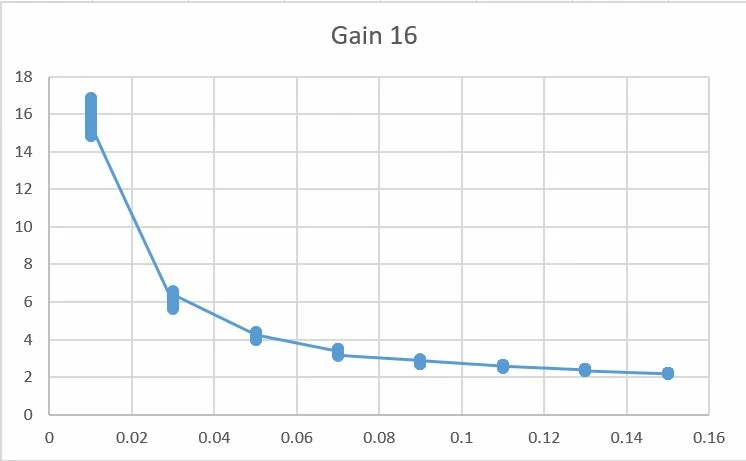

I am testing Examples/OPAMP/OPAMP_PGA/ in G4 package code, only to find the gain is not consistent as showed below:
0693W00000GWAeJQAX.jpgThe OPAMP input values are 0.01,0.03, ..., 0.15, and gain is 16.
However, I measured output at ADC side, the gain drops significant as input values increase.
What went wrong?

I have verified the example "OPAMP_PGA" - with small modification to input values (not sinewave waveform used in RAM but DC voltage in RAM). I used OPAMP input voltages (DAC output to OPAMP input) below 120mV to not overload the OPAMP output (120mV * gain16 = 1.92V). I have tested gains 2 .. 16 and all gains are correct.
I have tested voltages from DAC: 120mV and 12mV. For 12mV I have tested also gains 32 and 64. All gains are correct. I have measured OPAMP input and output voltages by multimeter. I have used DAC without output buffer to be able to reach such low voltages on DAC output (because DAC with buffer is not rail to rail). From measurement I determined that the OPAMP offset is about -1.5mV (no offset calibration used). This offset influences a bit the output voltage (because gain amplifies also offset) - because offset is added into input voltage.
Please measure in your configuration OPAMP input and output by multimeter/voltmeter - to determine exactly the correct gain values (oscilloscope is not precise for such low voltage measurement). If gains are correct then the problem is in ADC sampling the OPAMP output. Minimum sampling tine for OPAMP output is (according datasheet) 200ns.

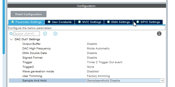

Do not use sample and hold mode for the DAC. Modify the example in the STM32CubeMX - this is the easiest way to modify the project (*.ioc file in the example is the file for STM32CubeMX). In STM32CubeMX change the DAC mode and build the example again.
Regards
Igor
HDaji.1
HDaji.1Author
Senior
November 12, 2021

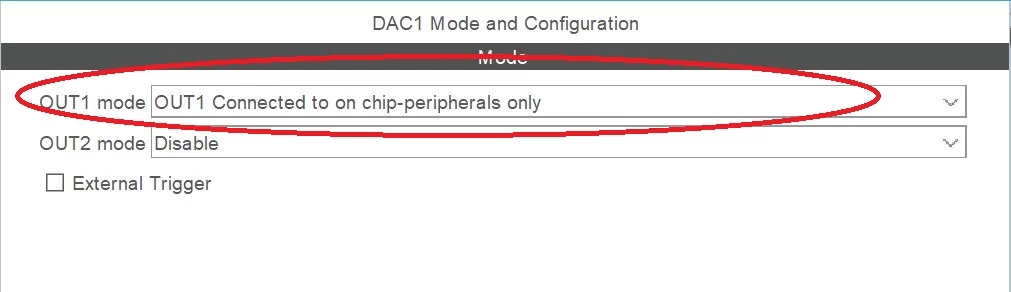

You mean this one0693W00000GXOluQAH.jpgand this one
sConfig.DAC_OutputBuffer = DAC_OUTPUTBUFFER_DISABLE;
 BTW, I am using CubeIDE not CubeMX
Igor Cesko
November 15, 2021
Hi HDaji.1 ,
Mode should be "Connected to external pin only".
And "Sample And Hold" should be "Sampleandhold Disable" :
0693W00000GXYX4QAP.png Regards
