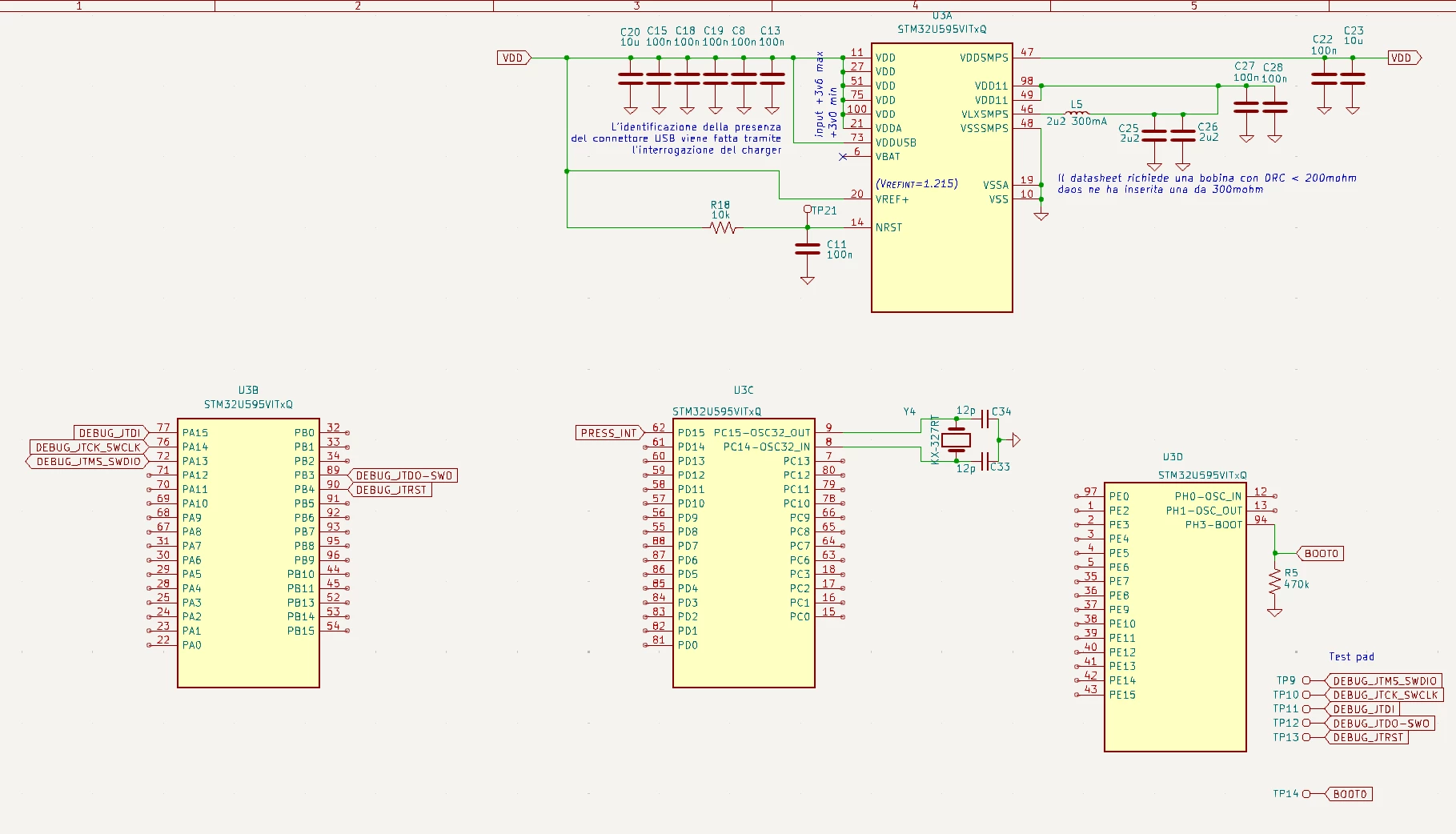

I’m facing an issue with power consumption in STOP2 mode on my custom board.
The board includes only the STM32U595 MCU, bypass and decoupling capacitors, and the inductor for the SMPS — nothing else is connected.
According to the datasheet, I expect a current consumption of around 4.65 µA in STOP2 mode (pag 214 Table 59, VDD = 3.3 V).
However, when I measure it with my STLINK Power Monitor, I get about ~10 µA with fast oscillations.
