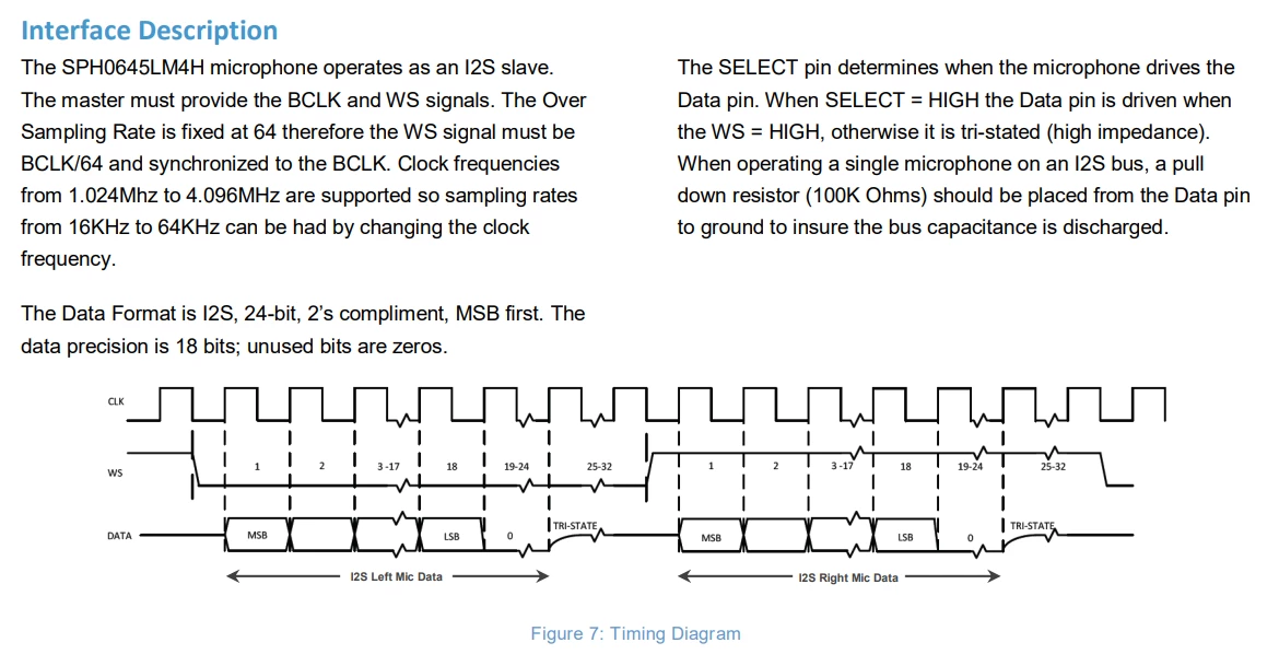

I am trying to get audio from I2S MEMS microphone (SPH0645). According to datasheet here -
https://www.knowles.com/docs/default-source/default-document-library/sph0645lm4h-1-datasheet.pdf
Basically I am supposed to get a 32-bit, where the first 24-bit is needed, last 8-bits should be ignored.

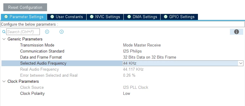

According to this, I have set the I2S pins as Half Duplex Master, with following settings -

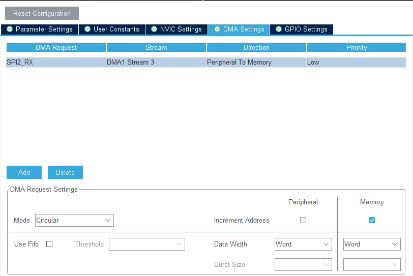

The DMA settings is given below -
Here as the frame size is 32-bits, I have set data width as 'word'.

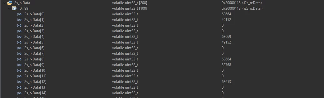

Now, my expectation was that each entry on data buffer would be a 32-bit number, but it seems I get 16-bit each entry. In debug mode, this is how the DMA buffer looks like.
The pattern is, 2 numbers 16-bit numbers, ending with two zeros. I dont know exactly why it behaves like this.

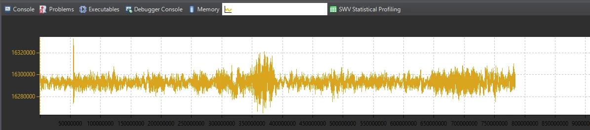

Processed Audio with zeros ignored -

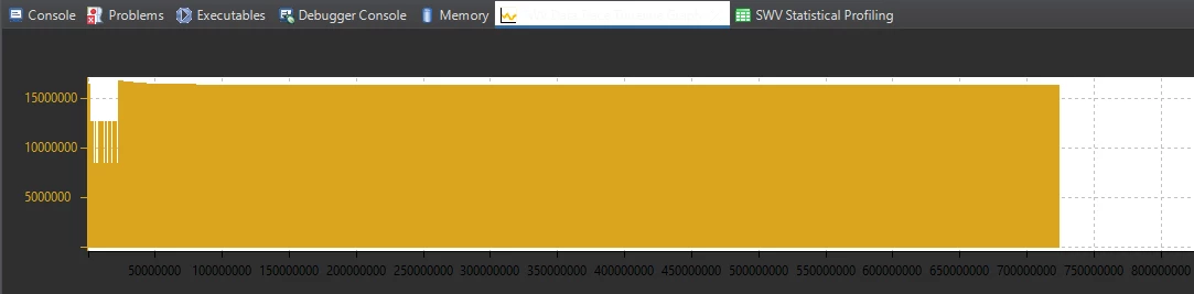

Without Zero Ignored -
This means, clearly there is something I am not doing right.
I have tried changing *Data and Data Frame format* on I2S settings and also Data Width from DMA request settings, but I am no sure where it's not going perfect.

Late response, but did you try 24-bits data (on a 32 bits frame)?
