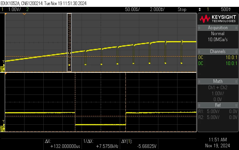

We notice the startup time from power up can be affected by setting one GPIOB pin to input. The startup time here refers to the time from SystemInit() until main(). Basically it contains scatterload and __rt_entry to my understanding.
Specifically, the sample code below, built with ARM Compiler 6.16 Tool, would demonstrate that
#define MEASURE_PIN 5

Basically GPIOA pin 5 is toggled to low and high for the time between SystemInit() and main() to be measured.
main() also has IWDG setup and ends with a while loop so that IWDG reset happens periodically since power up.

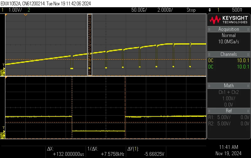

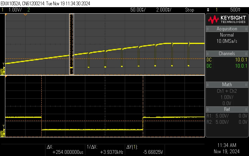

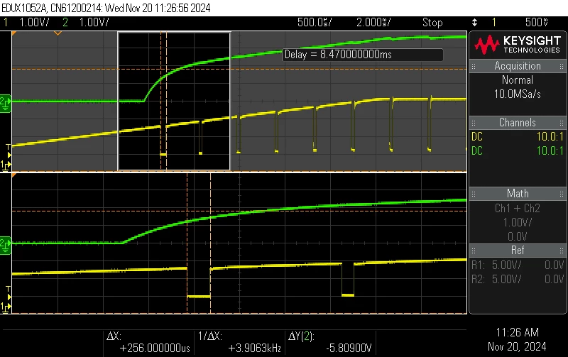

On the oscilloscope it looks like the screenshots below.
Respectively from the screenshots, it can be observed that the 1st startup(power up) takes 254 μs while the 2nd startup (IWDG reset) takes 132 μs.
Now if uncommenting this line GPIOB->MODER &= 0xffff3fff; and redo the measurement, we get the results below.
We can see that having the GPIOB pin 7 set to input reduces the startup time from 254 μs to 132 μs and the rest startup remains taking the same time.
Could you please confirm the following:
  1. What causes the differences between 1st and 2nd startup?
  2. Why setting GPIOB ping 7 to input would affect the startup timing?

Sorry, I did not read carefully enough. As I read the scope picture, the long first period happens well below 2.0 Volt.  HSI48 is only characterize from 2.0 to 3.6 Volt. I expect HSI48 to be much slower below 2.0 Volt.
Perhaps route HSI tp MCO and measure HSI frequency at voltages that low.

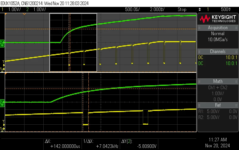

Is it possible to also probe the NRESET pin (If there is a capacitor on the NRESET pin please remove it) to see when it is released by the MCU after the Power On Reset ?
Best regards,
Simon
ah2Author
Nov 20, 2024 10:16 AM UTC
@Simon.T
On the NRST pin we have a capacitor 10kΩ pull up and a resistor 100 nF to ground, and we program the options bytes NRST_MODE to have Reset Input only.
The scope pictures are as follows:

Good. We can exclude voltage level as a cause. I do see a lot of voltage ripple in your scope images. Have you tried stronger decoupling?
