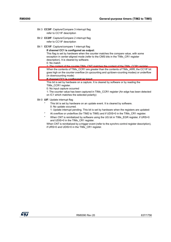

Undocumented behavior of capture/compare registers
I tried to set a capture/compare register to a value beyond that of the auto-reload register, and the timer I used (TIM8) behaved as if the value had not been written. Reading back gives the expected value though. I haven't dug more but I'm curious : is there some undocumented behavior that prevents the shadow capture/compare register from having the value of the preload register if that value is higher than the auto-reload register ?

waclawek.jan
September 2, 2024
What is the behaviour to expect, and how is the observed one different from it?
rbraunAuthor
September 3, 2024
Right, my bad.
The expected behavior is to never have a compare event such as an interrupt, since the value of the counter can never become equal to that of the C/C register. What I observe is that I do get interrupts, and the value of the counter is barely above zero, which is the previous value of the C/C register, as if the new value was somewhat ignored.

waclawek.jan
waclawek.janBest answer
September 3, 2024
That's an incorrect expectation.
