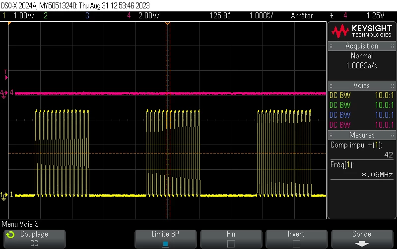

I'm implementing QSPI on STM32L451 with a NOR FLASH memory (Micron MT25QL512ABB, 64Mbytes) for the first time, using DMA, for the moment it seems to work, but I'm surprised by the timings.
CPU runs at 16MHz, QSPI clock speed is 8MHz. For this example I'm reading 256 bytes.

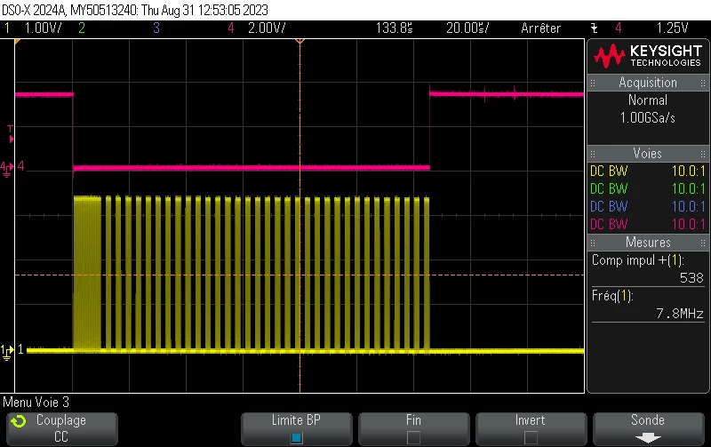

Full transaction :

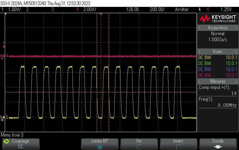

I'm surprised to see that the full read sequence is performed in burst of 7 bytes (14 clock cycles), spaced by approx 2µs delay between each burst. Since there is a FIFO on QSPI, there should no delay ? And why always 7 bytes bursts ?
While the transaction is running the CPU is running an infinite loop for debug.

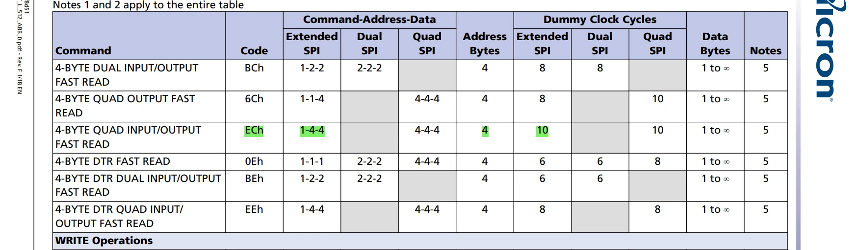

Hello @Aurelien Robert,
I guess you are using for the instruction command
CMD_READ_4B_QUADIO_INOUT
0xEC. If so, according to the datasheet, 1Line (instruction)+ 4Lines (address) + 2Lines (NbData lg)

Yes, this is the command I used. Where do you see 2 bytes for the data ? I'm reading 256 bytes... My first screenshot show a total of 538 clock cycles : 8 (instruction) + 4*2 (address) + 10 (dummy) + 256*2 (data) = 538. The data transaction part of the screenshots is split into bursts of 7 bytes, and I still do not understand why, I don't see your point when you counting the instruction and the address here...
When doing the same thing for writing data, there are only bursts of 1 byte (2 clocks cycles), spaced by approx 200ns delay.
