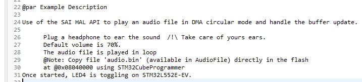

I would like some advice on understanding a code with an example provided with the STM32L5xx evaluation board. I have this code below :
 /* Initialize the data buffer */
 for(int i=0; i < PLAY_BUFF_SIZE; i+=2)
 PlayBuff[i]=*((__IO uint16_t *)(AUDIO_FILE_ADDRESS + PLAY_HEADER + i));
PLAY_BUFF_SIZE = 4096
uint16_t PlayBuff [PLAY_BUFF_SIZE];
#define AUDIO_FILE_ADDRESS 0x08040000
#define PLAY_HEADER 0x2C
I understand a little bit but where does the value 0x2C come from, what does it come from ? What does PLAY_HEADER mean ?

The WAV file has a 44-byte header. This skips past the header and reads the data.
 Where did you find this information ? Indeed, at the beginning it says that you have to load the music into a memory area.
Andrew Neil
Mar 28, 2025 2:40 PM UTC
WAV is a well-known, standard file format - it is well documented; eg,
https://en.wikipedia.org/wiki/WAV#WAV_file_header
