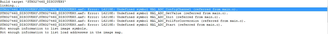

Undefined symbol HAL_ADC_... i added everything and the code show no mistakes yet this happen, any ideas ?

    Ok, so still points to HAL_ADC_MODULE_ENABLED not being defined. Select that text and 'Find-in-Files' within the project.
    \STM32Cube_FW_F7_V1.11.0\Drivers\STM32F7xx_HAL_Driver\Src\stm32f7xx_hal_adc.c
    &sharpifdef HAL_ADC_MODULE_ENABLED
    &sharpendif
    Should be in stm32f7xx_hal_conf.h

    &sharpdefine HAL_ADC_MODULE_ENABLED

    Check defines in stm32f7xx_hal_conf.h pulling in #includes, and that the stm32f7xx_hal_adc.c file is in the project tree.
    This is a linker error not a compilation error, so indicates the code behind the functions is missing.

    Thanks for the answer,
    But i did add all the needed files in the project tree this problem keeps happening

    I have zero visibility into your problem, the linker says they are not there.
    If the file is not missing, then you'll need to look to see if there is some ♯ ifdef around them preventing the body code from being compiled.
    Enable 'Browse Information', and right click 'Go To Definition Of ...' at the places where you call the functions.
