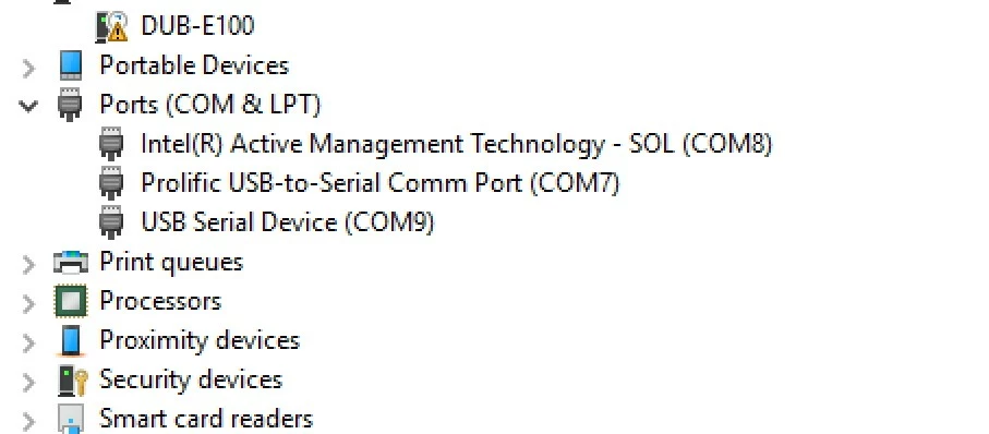

    Now i got my composite device working any idea why i can't connect to USB Serial Device COM Port?
    arduo
    arduoAuthor
    February 7, 2019
