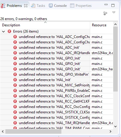

Hello everyone, i guess this is not the right place to ask, but official Atollic TrueSTUDIO forum gave me no answers. Maybe someone here had same problem as me.
Yesterday i moved from Keil to TrueSTUDIO IDE since it is free for STM32. After base code generation using STM32CubeMX i can't get over the error after building Debug. It does not find reference to any HAL and FreeRTOS functions. If i try to build Release the errors does not appear. Also then i try to RUN my project i get 'The selection cannot be launched, and there are no recent launches.'. What could be wrong?
P.S I am junior developer and never used debugging tools. Does Debug build and run is just as same as flash + use of debug tools

    Hello
    matiukas.arnas
    This issue is now fixed in the current CubeMX release.
    Please, upgrade with CubeMX4.25 if not already done.
    BR. Jeanne

    Hello
    matiukas.arnas
    This is a known bug reported in this
    https://community.st.com/0D50X00009XkWopSAF
    and will be fixed in coming version of CubeMx.
    Best Regards
    Imen
