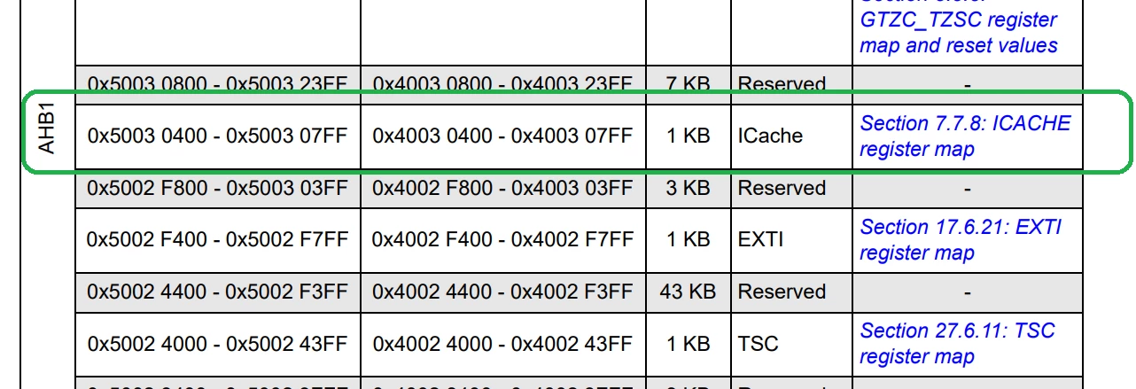

2) How do I generate a dump of the ICACHE?  I thought this was internal to the core so I wasn't aware there was a way to "inspect" its contents.

Here are the ICACHE register map for the configuration and status bits
