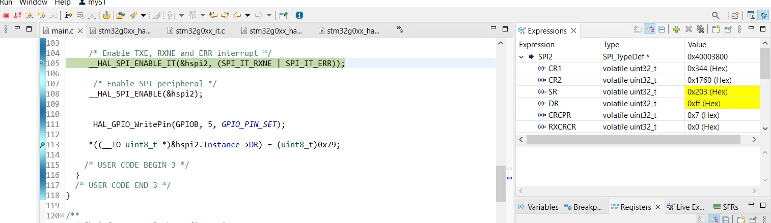

Unable to write Data into SPI2->DR register in stm32g030k6t6 MCU
Hello ,
I Have configured STM32G030K6t6 MCU has SPI master . I have used SPI2 Module. Chip select is controlled manually by GPIO .
I am unable to write exact data 0x79 in SPI2->DR register . Always it writes 0xff  to DR and i am unable to read/Write anything from Slave. Kindly provide inputs

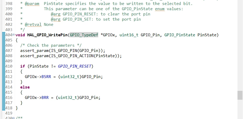

waclawek.janBest answer
October 6, 2023
 HAL_GPIO_WritePin(GPIOB, 5, GPIO_PIN_RESET);
You are not supposed to use a number as the second parameter. Read the comment to that function:
 This parameter can be any combination of GPIO_Pin_x where x can be (0..15).
i.e. you should write
 HAL_GPIO_WritePin(GPIOB, GPIO_Pin_5, GPIO_PIN_RESET);

waclawek.jan
October 5, 2023
SPI_DR is not a memory-like register and you won't be able to read back what you've written to it. It in fact is two registers - when you write it, you write into the transmitter's buffer (FIFO), when you read it, you read the receiver's buffer (FIFO).
Observe the SPI signals using oscilloscope/logic analyzer.
Nchun.1
Nchun.1Author
October 6, 2023
Hi @waclawek.jan
I found issue is resolved after using below GPIOB->ODR register manipulation directly instead of using BSRR ,BRR for Manual Chip select
When i checked signals with scope using BSRR,BRR registers GPIO CS output is not stable till the transmission is completed. kindly explain difference between ODR and BSRR ,BRR registers
GPIOB->ODR |= 1 << 5 ;
GPIOB->ODR &= ~(1<< 5);
Thank You
Tesla DeLorean
Guru
October 6, 2023
Parking a Peripheral view over registers which change others where read, or FIFOs, will result in interference with normal functionality.
Doing an RMW on ODR will take many bus cycles to complete a load store operation. Whereas using a write to BSRR takes effect in a single cycle of the GPIO clock. It's an atomic / efficiency thing.
