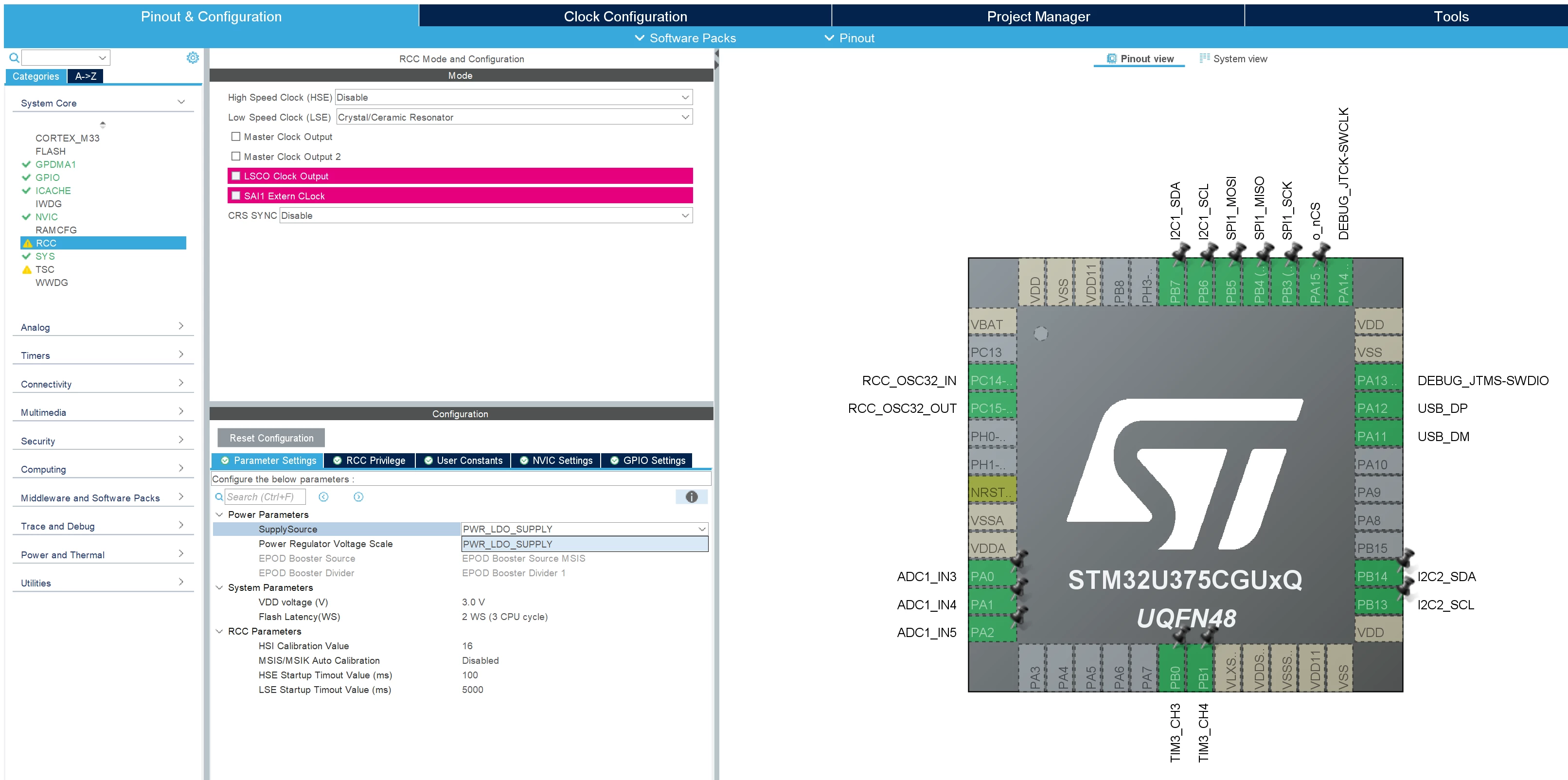

I'm currently trying to configure a project based on an STM32U375CGUxQ, but I can only "choose" the LDO, even though the package clearly shows the SMPS pins:
I'm using the STM32U3 package version 1.2.0, STM32CubeIDE 1.19.0, build 25607_20250703_0907.
Are there any prerequisites to being able to use the SMPS, and if so, what are they?

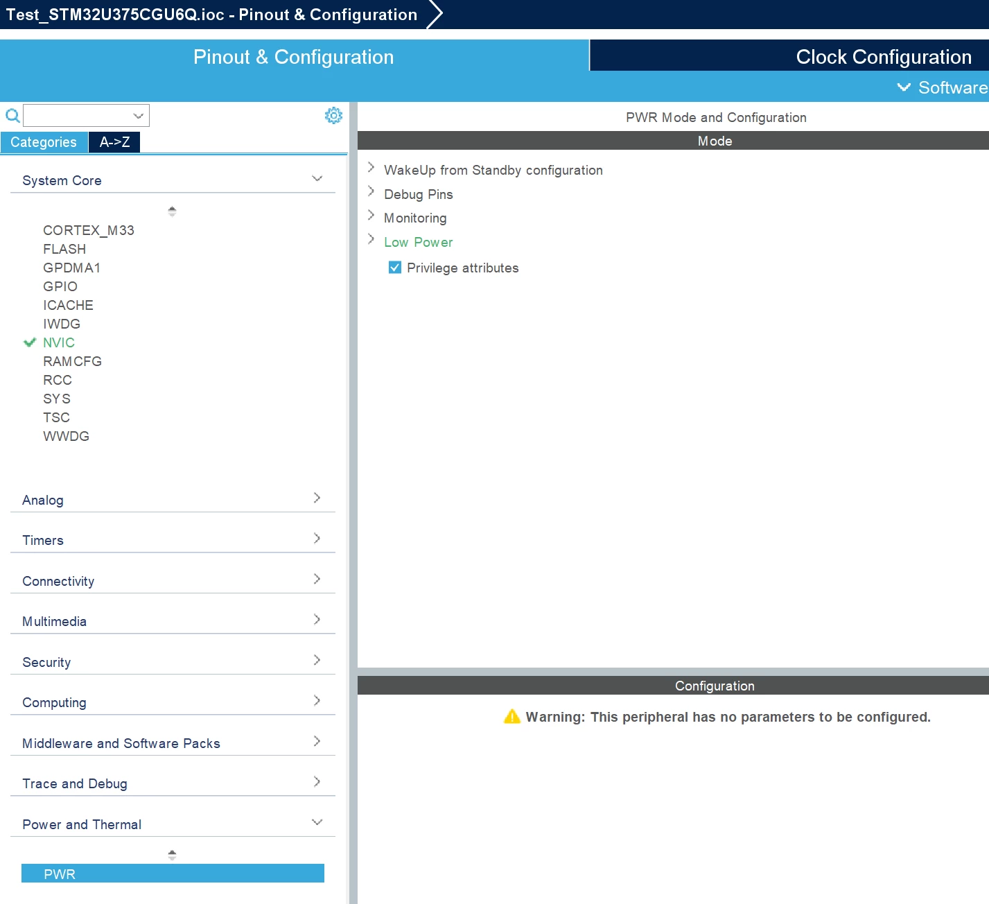

NB: There doesn't seem to be a "Power saving mode" under the PWR category:

Hello @cjb89 ,
Similar issue is reported here.
I confirm the issue. It is a STM32CubeMX issue.
I reported internally for correction.
Internal ticket number: 214214 (This is an internal tracking number and is not accessible or usable by customers).

The issue is fixed in STM32CubeMX 6.16.0 version.
Thank you.
