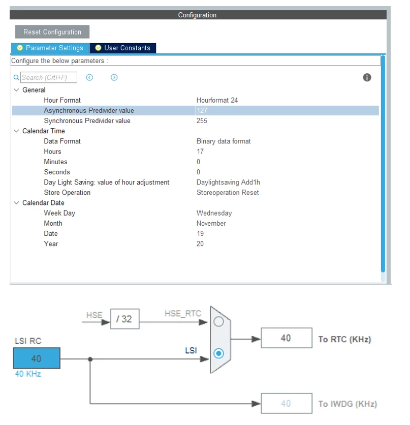

Hello all,
I am unable to save time or restore proper time after I remove Vdd from my MCU when connected to a external 3V li ion battery (DL2032). After every power cycle my time gets reset to its initial default value.
When I supply 3V from a regulated power supply RTC time works as expected. Can anyone please suggest me what kind of external batteries are to be used for STM32F042k6 or is there a special circuit that I should follow?

I am measuring the 3V across VDD (Vbatt) and Gnd terminal when the chip is powered by external battery. Yes, it might also be a software problem. I created the skeleton using STM32CubeMX and have attached a snippet of my configuration.
In the main.c file, I am using HAL_RTC_GetTime(&hrtc, &sTime, RTC_FORMAT_BIN); and HAL_RTC_GetDate(&hrtc, &sDate, RTC_FORMAT_BIN); api to read time and date.
Please do let me know your thoughts on this.

First of all: in STM32CubeMX you have selected LSI as clock source, whose main usage is to clock the IWDG (Independent Watchdog), which is required for safety applications, where accuracy doesn't matter. The LSI is an independent but rather imprecise clock - the datasheet of the STM32F042 mentions 30...50kHz, i.e. +-25%. You can get an error of +-6 hours/day (yes, six hours) using the LSI instead of the more precise LSE for the RTC.
But back to your main issue: it is probably raised by a feature (not a bug :smiling_face_with_smiling_eyes:) of STM32CubeMX, which sets the predefined values for time/date and so on in the skeleton program, so it always overwrites (resets) the current RTC values after a reset. This predefined behavior can be useful i.e. when debugging a program, but is somewhat inappropriate when introducing an application being rolled out. A solution compatible to the workflow of STM32CubeMX and STM32CubeIDE has already been discussed here.
When your question is answered, please close this topic by choosing Select as Best.
Good luck!
/Peter
