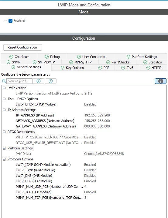

I am trying a simple example code for running the server in stm32f407, I have used LAN 8720. The connection are as follows:

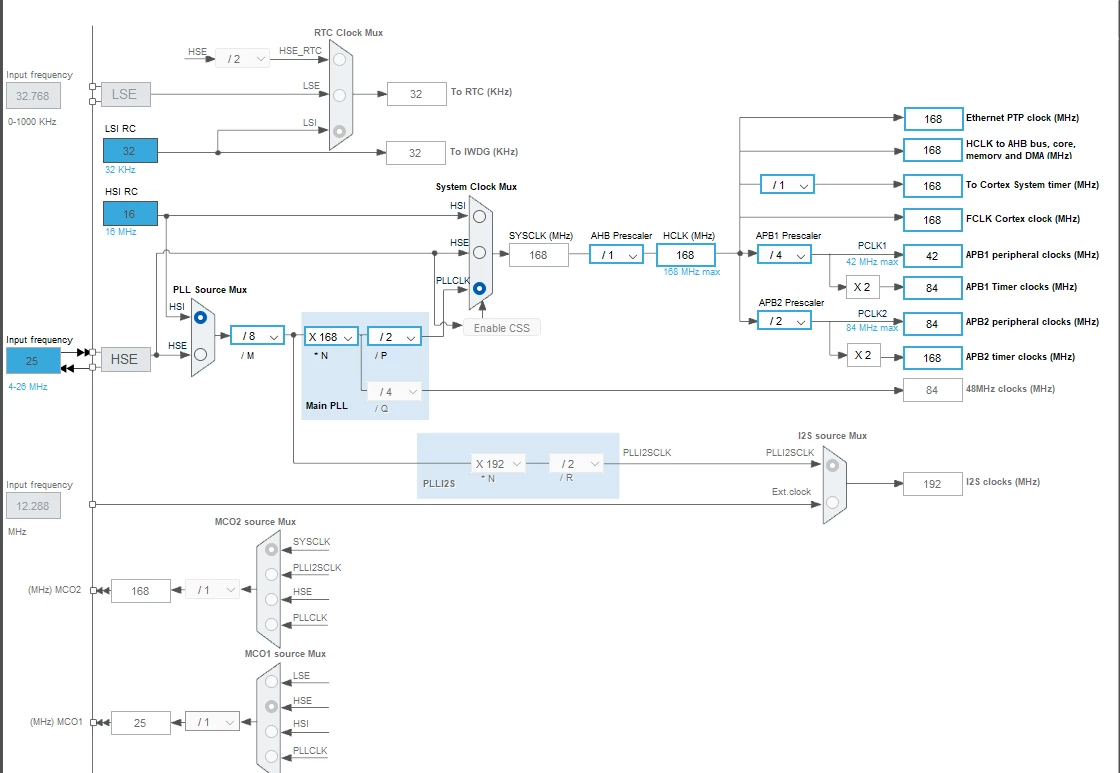

my settings in the cube ide are:
RCC--> HSE:crystal/ceramic Resonator
SYS---> Debug: trace asynchronous SW
CONNECTIVITY----> ETH: RMII
MIDDLEWARE---> LWIP setting:
My  clock configuration settings:
my main.c is attached below.
I am not able to figure out the problem. I am pinging the IP and it is not responding, the page is showing error "server not responding"

Apr 3, 2025 7:35 AM UTC
It worked with STM32cubeide version 1.8.0 where in lwipopts.h there is a parameter named HTTPD_USE_CUSTOM_FSDATA from 1 to 0.
But this is not there in version 1.15.1

Nov 25, 2024 11:16 AM UTC
I am trying to run this simple program, without using RTOS, when i enter the ip it should respond me with "Hello World"
