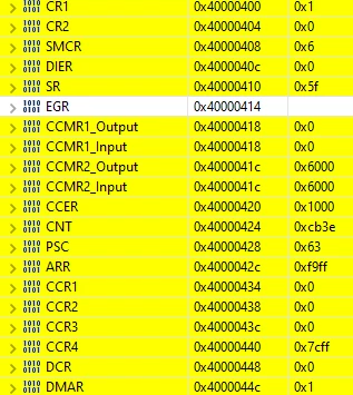

I am trying to set up two timers so that they generate a PWM with the second timer being 1/4 phase past the first one. I am using an STM32F446.
I have the second set up as slave and triggered by the OCREF2 of timer 1, this should then generate a reset of timer 2. Below is my timer init by cube mx and I'll also post the registers.

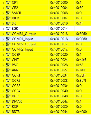

The registers after initialization look as follows:
TIM1
0693W00000QKxDDQA1.pngTIM3

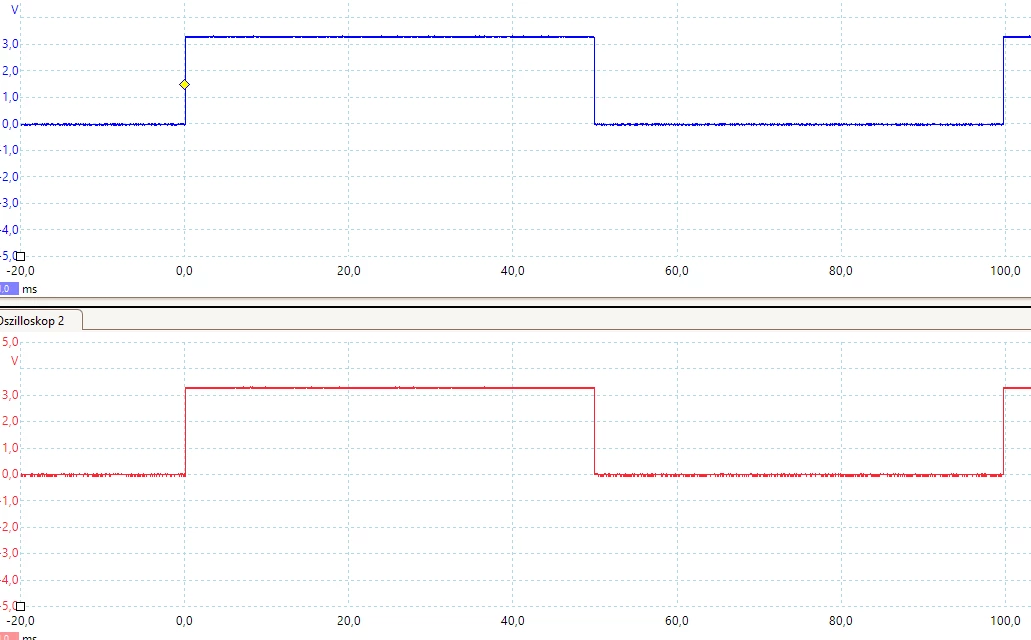

With this setup my signals are just in phase, with the second one just 40us behind, which you cannot see in this snap

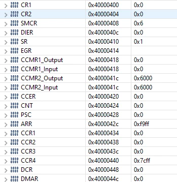

waclawek.jan
July 12, 2022
You want them both to be set up completely, except for enabling the counter, i.e. you want both TIMx_CR.CEN=0. After that, enable only the master timer's counter.
I have no idea how to pull this out with Cube/HAL, I don't use it. It's way simpler to do it in registers.
gfxfloro
gfxfloroAuthor
July 12, 2022
I worded that badly, the registers look like that after starting the counters, before that they are completely set up. The timers are then started with a call to HAL_TIM_PWM_Start(...) which does exactly what you described (omitting the enable for the triggerd counter). Still the waveforms are in phase

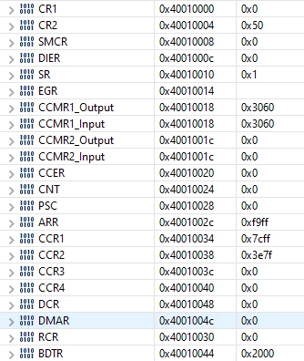

waclawek.jan
July 12, 2022
Show.
gfxfloro
gfxfloroAuthor
July 12, 2022
TIM1 after call to MX init
0693W00000QKyF5QAL.pngTIM3 after call to MX init
