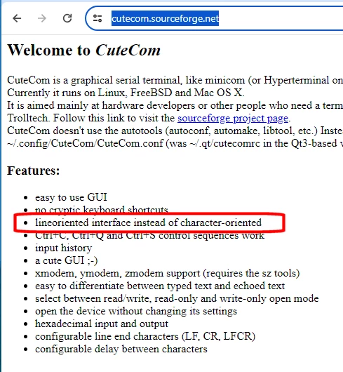

@Andrew Neil wrote:
"cutecom" (not heard of that one before) .
This: https://cutecom.sourceforge.net/ ?
I note:
So are you sure that your code is sending in a proper format that CuteCom will recognise as a "line" ?
